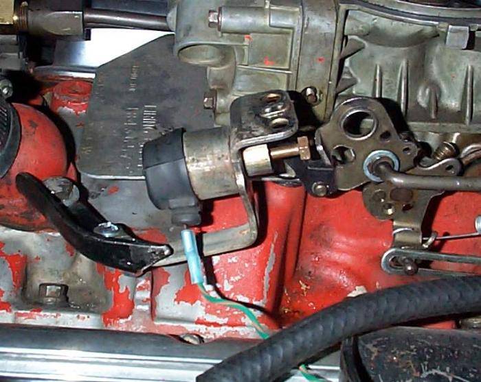

It would be great to switch to high idle at will...
Well, lot's of cars came with solenoids to change idle speeds. Switch on the A/C and the solenoid would energize and push against the throttle and bring the idle speed up. You'd have to find the right combo to do it, but I don't think it would be that hard.

I like the solenoid device and the police fast idle lock but I think after perusing our options it's probably best to go back to where your instincts took us originally- test the **** out of it, make repairs/adjustments, upgrade wire sizes where appropriate and see how it behaves.

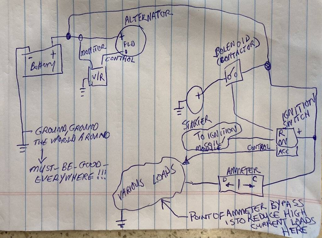

It’s good that you are checking into the details on their product. Continue doing that post what you heard. Regarding the loads and how it’s distributed I’ll try and put together a cartoon that shows what the system typically looks like. However, the specifics will be in your shop manual. Get one of those if you don’t have one.
I’ll try to post the cartoon response response to this message later today.
this is a quick cartoon of the functionality.
It is NOT gospel, but provides a high level of information so as to understand.
The purpose of the ammeter bypass is to reduce the heaviest electrical loads through it.
I likely have forgotten something and others will likely point that out. However, my aim is to get you understanding what is going on with the electrical system.
I hope that this helps.

Last things first, the voltmeter just plugs into the cigar lighter. BYW, in a Mopar, it's a cigar lighter. One of those things that differentiate us from the others. LOL.
Here's one. https://smile.amazon.com/LIHAN-Char...9Y2xpY2tSZWRpcmVjdCZkb05vdExvZ0NsaWNrPXRydWU=
Regarding the wire size, as I said, there's some discussion if the existing wiring is robust enough for a larger output alternator. Again, it's all about how much amperage the system needs that will determine wire size, not necessarily the source, but upsizing the wiring is a fairly gargantuan task. So, the best answer goes back to the bypass... that you don't want to do...
Throw in where the fusible link is. That can help 'splain some stuff too.
