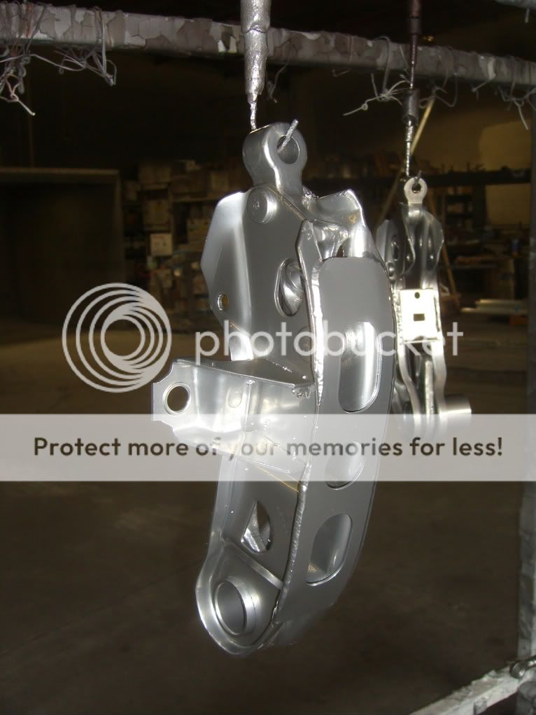

These Formals don't need any extra stiffening. Trust me. I swear they were originally designed to be Power Wagons.

Unless the C bodies are different than B's those LCA's could probably do with some stiffening since they are off or soon to be. But you aren't going to be running slaloms so who cares .. I get that.

Hey Talhair, have a look at the pic of Stans LCA and you can see it has a round ball joint in it, its a totally different animal to the earlier LCA's in our cars, the torsion bar being about the only similar thing.
