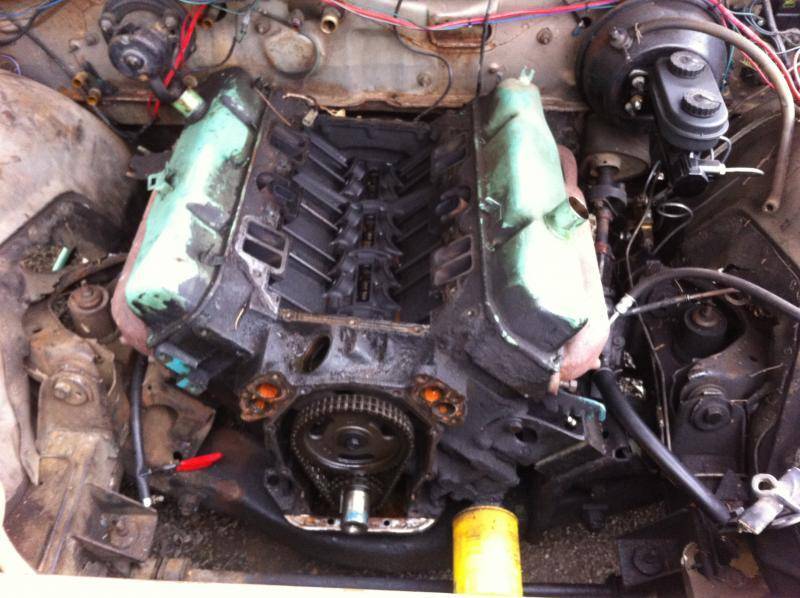

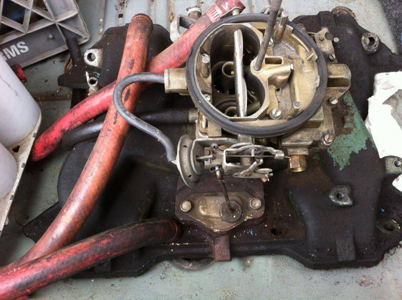

well the random stalling from lack of fuel, as it turns out to be from the pump rod. it banana ed and was sticking... well we got this far and figured **** it has 175k and should probably just rebuild it now instead of tearing it down in the next year or two anyway. it always gets deeper before it shallows. and yes 4bbl and intake are coming, so anybody that wants the old efficient 2bbl and intake give a shout out. it will be out and to the machine shop by the weekend IMG_0798.jpgIMG_0800.jpg

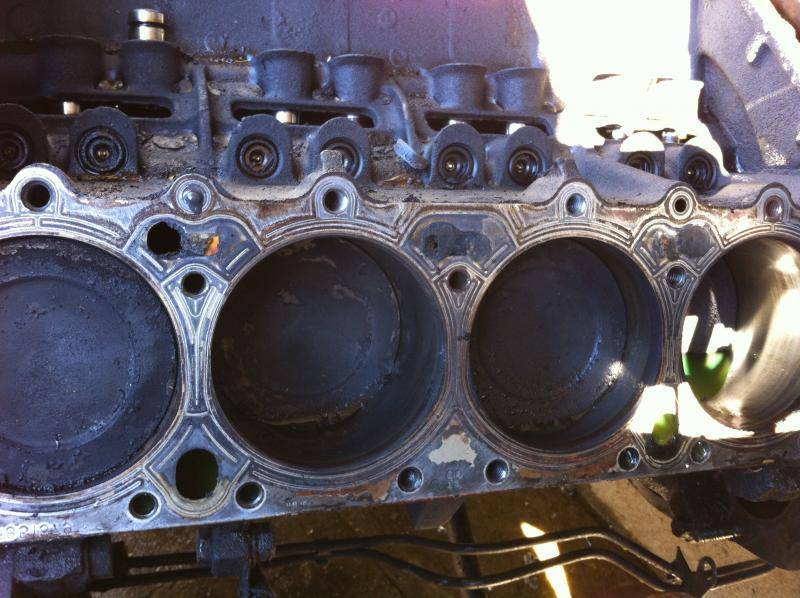

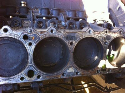

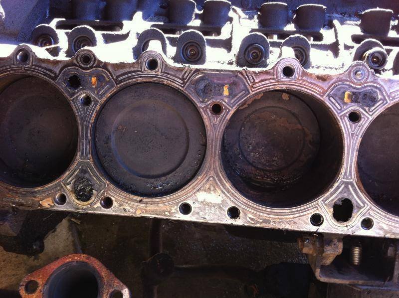

small update. heads off lots of blocked water jackets, no wonder it was running warm. it also has the small exhaust valves so it time to go larger or update to 906's. light cylinder wear nothing .0030 won't clear up. game day so its quitting time. block out tomorrowIMG_0804.jpgIMG_0805.jpg
Nice progress, can't believe those water jackets, damn. Those babies were clogged.

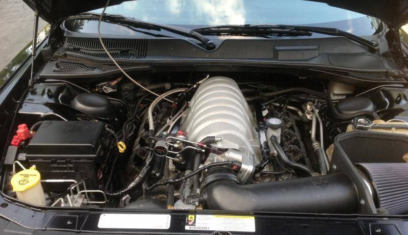

Here's the nice clean engine bay of my summer daily driver, by the way. This thread made me think to go look for a picture...
