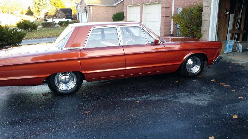

Good afternoon all,
I have to start this out by saying I have spent the past 2 hours fighting to remove my rear passenger wheel.
I have a 66 fury III with non removable fender skirts. I jacked the car up at the rear differential and had the jack stands, the whole nine yards. When I took the lug nuts off and tried to take tire off it kept hitting the inner fender. I can't tell you how many times I twisted and contorted my body trying to get this off (cirque du soleil would be jealous) and it keeps getting stuck. There isn't enough clearance to move the tire up and then bend it out either. I think maybe there's a different jacking point maybe somewhere that I've clearly missed. I feel like by jacking it up via the differential it compressed the suspension so much that it just ate up the precious few inches I require to take it out. I've searched on the forum here but either I'm not using enough search terms or just not the right ones but I've struck out every time.
Cheers guys
Any help will truly be appreciated.
I don't see any skirts in that photo. The thing to do is to jack the car up and put jack stands at the front leaf spring mounting point. The suspension will hang and it should give enough room for tire/rim removal.
I have 15x8 rims on the rear of my 65 Sport Fury and that is how I have to get them on/off.

nice car...cant remember seeing a shaved 4dr ...l like

I forgot to add that you own a very nice looking Fury! what is under the "bonnet" as they say over the pond? Love to see more pics of your Fury III
