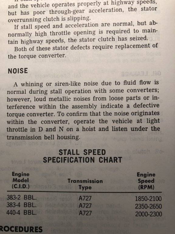

I have my '68 727 in the shop now for a rebuild. I have a 350hp 440. In the FSM they reference a regular torque converter and a HP version. I assume I have the regular. Does anyone know what the other one is and why I might want it. The FSM does not say much about it.

There were 2 different sized torque converters having various stall speeds due in part to size of the converter and the HP/Torque of the engine and weight of the car.
The "Standard" TC for the 318 904 is shown as 10 3/4" while the 727 used the 11 3/4".
The "Standard" TC for the 400/440 is the 11 3/4". The "High Stall" TC is used on the 340/360/400/440 with the 727 is the 10 3/4." However, the larger 11 3/4" is shown used on the high-performance 440 cars as well (less slippage). From the 1973 Manual:

There are two general sizes of TF 727 torque converters. The 10.75" is the small one and 11.75 is the big one that's probably behind your 440/350 engine. The best way to tell is that when you do a trans fluid service, the smaller torque converter takes less fluid to get to the "FULL" mark on the trans dipstick. Which can also be determined by the fluid capacity specs in the FSM.
In the graphic above, the 383-4bbl obviously has the smaller converter behind it, whereas the 383-2bbl and 440-4bbl have the larger converter. The 383-2bbl and NY 440/350 would obviously have the 2.76 std axle ratio, but the 383-4bbl would have a 3.23. But a 300 440/350 would have a 3.23 std ratio. usually.
