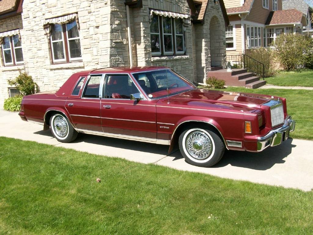

I have the coil over shocks on the 1979 New Yorker. They appear correct height and do not have a bouncey feel as the ones that are placed over the shock as an afterthought.
