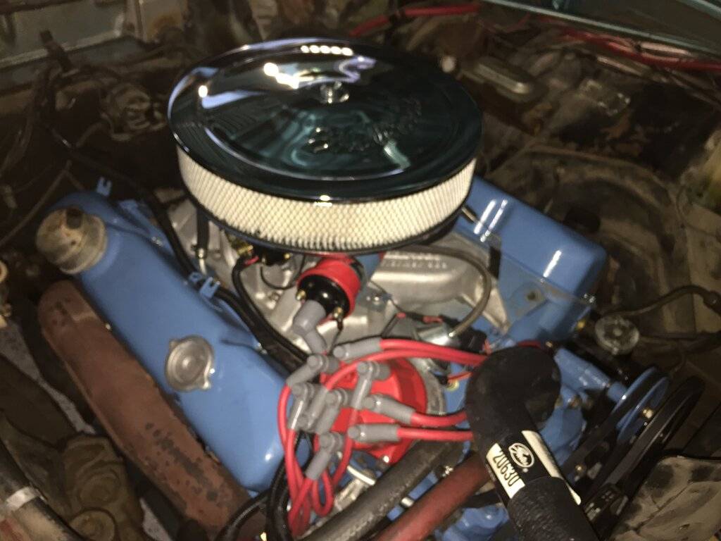

2186 intake with 750CFM Eddy carb. 68 383 Newport Custom
My car was a 2bbl car.
For a stock look I grounded off the Edelbrock name off the intake and painted engine color,and use a factory 4bbl air cleaner.
You can get away using the 2bbl throttle cable but can use a slant six cable from any Mopar (it is longer) or the correct 4bbl throttle cable.
I did install the correct 4bbl trans kickdown linkage and adjusted it accordingly.
Get a carb with electric choke.
Use the switched side of the ballast resistor (blue wire) to power the choke up.
With electric choke,the exhaust heat crossover passage is not needed so I recommend blocking it when installing the turkey pan and intake. Reason is keep the temps down at the base of carb to eliminate fuel perculation.
Make sure you get the throttle adapter for the carb to work on Mopars.
Hope this helps.

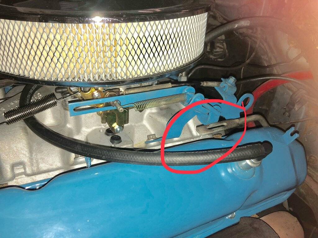

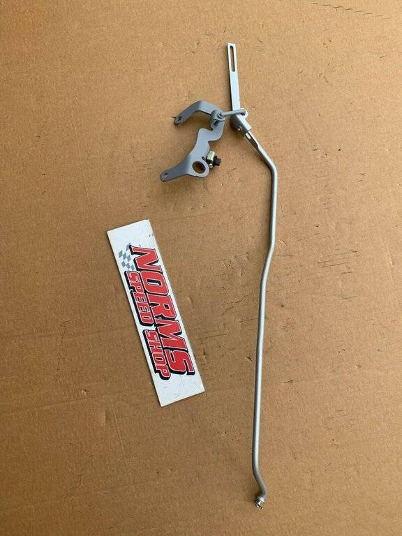

Hey cbarge, was going through some of my old posts. I recently rebuilt my 383 engine from my 70 chrysler newport and changed my intake to a #2186 edelbrock and changed from the stock 2 bbl to a 4bbl edelbrock #1406. I need help sorting out the kickdown linkage situation. I did buy this one, what do you think? its from a Mopar 440 4BRL Passing Gear Kick Down Linkage Set B E Body Coronet Charger
heres a link to where my latest discussion is: “Jackie Blue” will get a fresh engine rebuild!
Also if I could get some close up pictures of you linkages to your carb and to kickdown area would be helpful. Thanks In advance!

Bad69fury View attachment 412605 View attachment 412603 View attachment 412604
My kickdown is the period correct 3 piece rods. So pics will not help you.
The kickdown set up you bought is for later model cars.
Nothing wrong with your set up,it makes adjustments easier.
Just make sure you have the rest of the matching linkage from the trans to the new rod.
Hope this helps.
Hope this helps.
