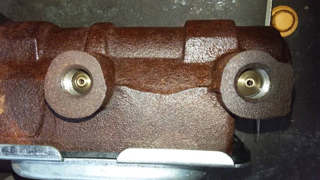

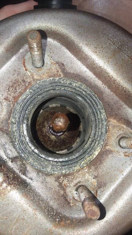

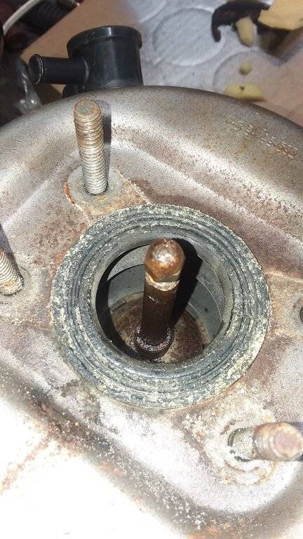

Guys I would like your opinion. I'm putting my Dewey booster on. When I looked at the back of the master there was some yucky moisture. Not a lot, in fact I cleaned it out with one q tip.
Do you think that indicates a learning master cylinder?
See attached pictures. The one of the master cylinder is after cleaning.
Or is it just moisture causing rust?
If you have any doubts about it leaking, replace it. Not worth risking a fresh booster to find out.

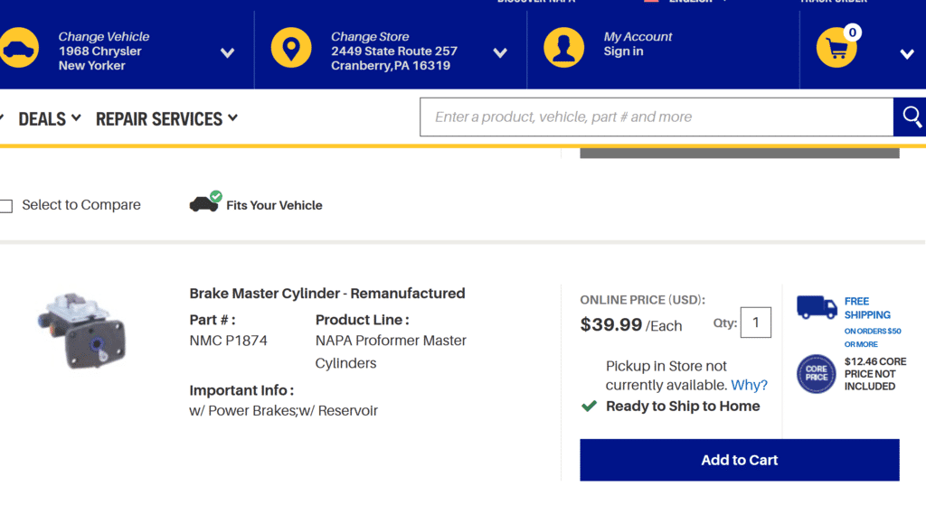

John. If you wind up going re-man. If it waz done by Cordone WALK AWAY FAST. They used to sell crap when they were domiciled in New Jersey. They moved their entire operation to Mexico 'bout 8-10 yearz ago because of the Cheap Labor soooo? Personally, I'd try to find a new one, try ROCK AUTO. You'll find Cordone there too but now you've been warned 'bout that outfit. I had ah kid in a cycle shop one time ask me how much should I pay for a helmet. I waz just in there buying some Klotz for my 2 cycle Dirt Bikez so I answered him with a simple question: HOW MUCH IZ YOUR HEAD WORTH? I feel the same way about Brakez, Jer
John. If you wind up going re-man. If it waz done by Cordone WALK AWAY FAST. They used to sell crap when they were domiciled in New Jersey. They moved their entire operation to Mexico 'bout 8-10 yearz ago because of the Cheap Labor soooo? Personally, I'd wait for the new one from Napa. I had ah kid in a cycle shop one time ask me how much should I pay for a helmet. I waz just in there buying some Klotz for my 2 cycle Dirt Bikez. I answered him with a simple question: HOW MUCH IZ YOUR HEAD WORTH? I feel the same way about Brakez, Jer
You can preach that all day long. I've got a new one coming from a local parts house that I deal with routinely. The only thing more important that going is stopping I've been known to say. I don't buy cheap helmets either. They normally run $300 or more. Unless I can find last years model being clearance. I've been looking lately and the best price I can find for what I like is about $330 then they go up to about $500.

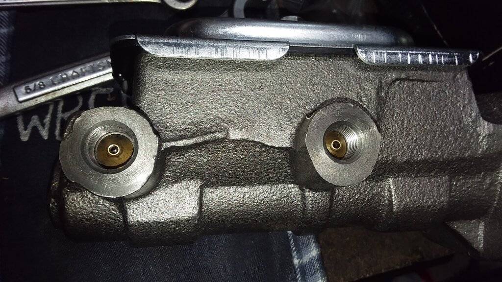

I got the new master today. I remember someone saying about check valves in the ports where the lines hook up, but I cannot remember for what setup. Old and new look identical - are they correct.
I got the new master today. I remember someone saying about check valves in the ports where the lines hook up, but I cannot remember for what setup. Old and new look identical - are they correct. View attachment 384186 View attachment 384187
Those are both offshore replicas of the original 4 wheel drum MC. They should have a residual pressure valve beneath each of the brass fittings although you can't see without removing them. Cross your fingers and say a prayer that it works as designed. Hopefully you're luckier than I have been.

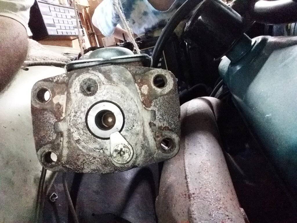

Shorter or longer? I checked the length of the rod before assembly. The best I could tell is that it was a .010 longer than the book said the range was. I'll give it a try when I get a chance.
No slop between the push rid and the MC piston, just bottomed into the piston hole John, and believe me when I tell you that an 8th" of ah turn can make the difference in too much or too little of what you think you've got. Trial and error Pal, Jer
