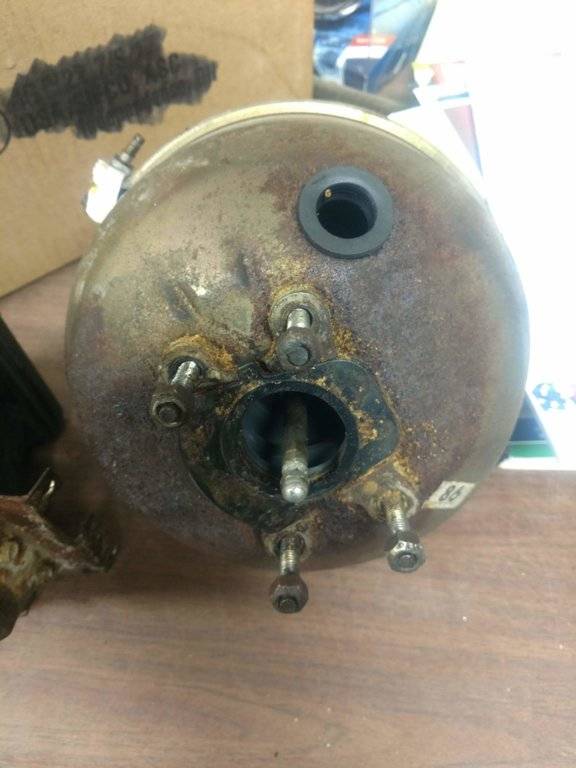

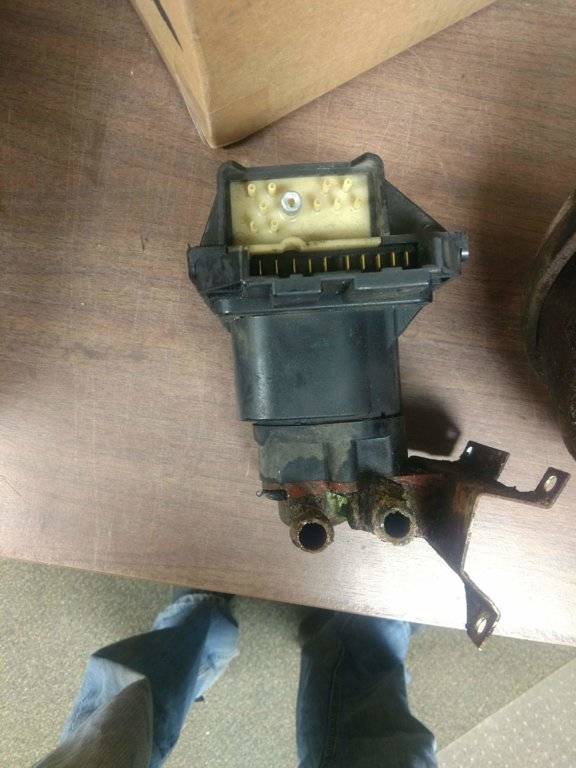

Booster sent off for rebuild and ACC pump.

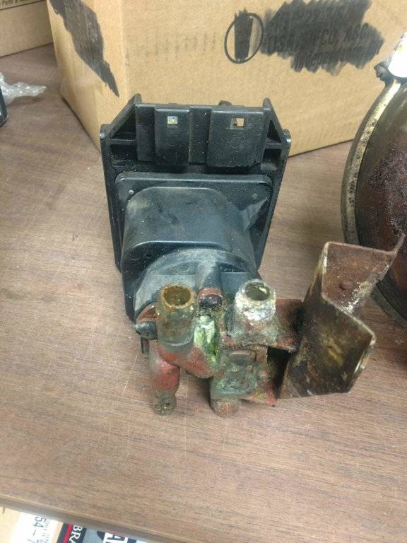

View attachment 205077 View attachment 205078 View attachment 205079

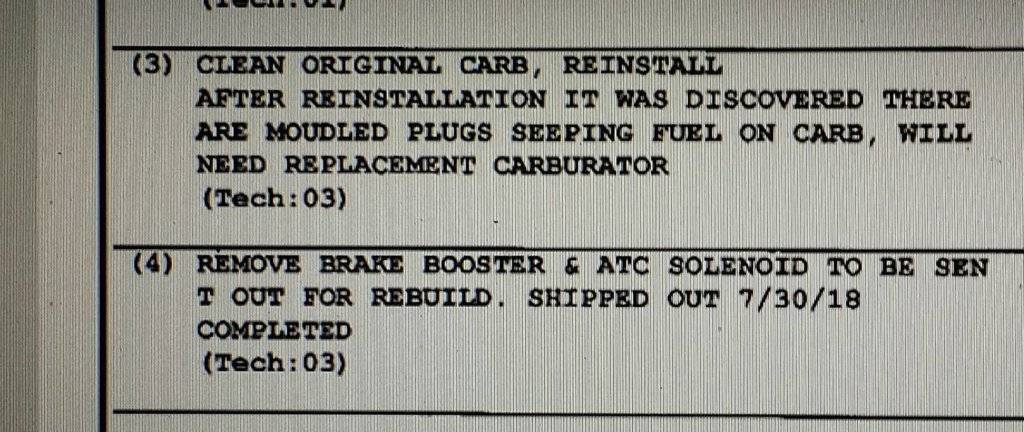

Molded plugs may be the main jet wells. If so, they can be carefully removed and reset with JB Weld.... Don’t replace the carb if you don’t have to. As long as the throttle body is good, you can replace the phenolic body.
Problem with replacement rebuilt TQ’s is they trend to be an amalgam of parts for different years and carbs.
Main jets, needles and throttle bodies need to be correct for the car.
And as I’m learning the hard way... floats need to be brand new.

Thanks Javier. I appreciate all the advice from the seasoned forum members...Marv also advised to keep carb. This coupe sat so long there was extreme rust in tank and carb, etc...I think my mechanic Pat tried everything to save it...actually I think I'm into the rebuild carb about 600.00 in labor/parts and we have to toss it anyway. I can mention it to him just to make sure no pulse left. I personally have not had any issues with other carbs. A different shop swapped out a carb on my 59 Impala, no problem...of course I sold it to make room for Imperials...hahahaha...And Big Red's engine (E5 72 4 dr) is far from stock and she runs like a sewing machine. I'll ask again as I'm headed down to shop next week to check on progress of coupe/photoshoot and Tina Patina (A5 73 4dr) is next in line on the rack.

If you have the chance to keep the carb then use it. Even if you spend some bucks to refurbish it... If you get a new holley or edelbrock carb you should also go for a matching intake and air filter which will end up in more than 500 bucks

Update: Mechanic using Edelbrock 500 cfm carb with original intake. Keeping original carb if there's issues down the road.

Isn't 500cfm a little small? I know they're Chevy guys and all.:poke: But that seems small to me, I'd think at least a 650 or so, I always slap.on a 750 as my carb size of choice.
*Feedback from mechanic today: I should notice no difference between 500 and 650 cfm...and 750 cfm's too much fuel for that engine.
I'm learning as I go on these Imperials. I won't know until I drive her if 500 cfm ok.
I hope he's right, or I'm wrong. I just wouldn't go any smaller than what the factory installed.
