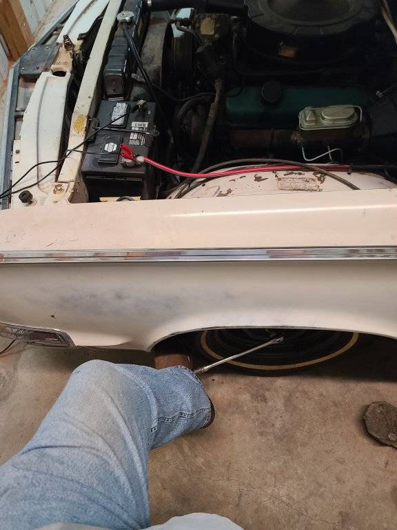

I'm having a hell of a time getting my lugnuts off on my 66 300. I moved to Mississippi recently so I think rust may be the issue. I've used my 1/2" impact with 1000lb/ft of torque but no luck. I've also tried jumping on a breaker bar to "shock" the rust loose. Still lo luck. Any suggestions? Should I apply heat at this point? Any help would be greatly appreciated.

You're not the first to get caught by these. At least you didn't tell us any of them sheared off. A friend of mine had his '70 Hurst in a shop for a restoration; the guy broke three off and was working on number four when I told him to reverse his impact gun. He looked at me like I was form Mars!
If you really used 1000 lb/ft the wheels would be loose, no problem, whether LH or RH thread.
I am reading this thread thinking to myself “ @MetalManiacAZ must be experiencing some type of dementia, he must know these are reverse threaded…”. This was a good one!

Haha! I'm actually talking to Craig (Mobileparts) about getting a correct set as the ones from my original drums are a little too short for the rotor.

I am curious, because on my 66 the left front were RH, and the back were LH with one broken. I changed those rears to RH, and will have to add a label to the fender skirts. But wonder if some came with RH on the front left....thought I saw that somewhere. And, of course, my car had chrome nuts, cannot see the stud end. And I had to laugh at the above Science note.....I think this is Fauci science on the left hand thread nonsense. Left hand wheel studs, left hand axle nuts, and left hand knockoffs.....crap.
