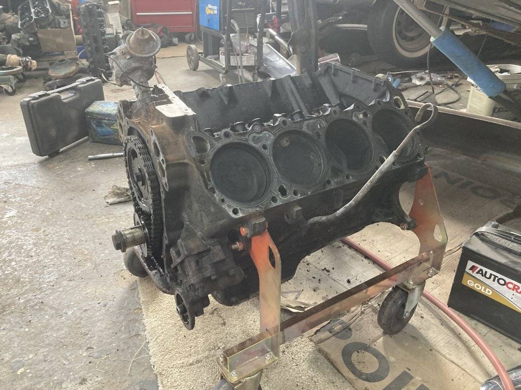

As I said in a previous post, the bottom end of the engine is in need of a rebuild. It feels considerably more tired every year, the blow buy out of the breather has gotten worse and the rear main just keeps getting worse, oh and did I mention the trans?? The worst part is because of all of this is that I don’t drive it much anymore and in fact I hardly even see it anymore as it’s stored across town…:(

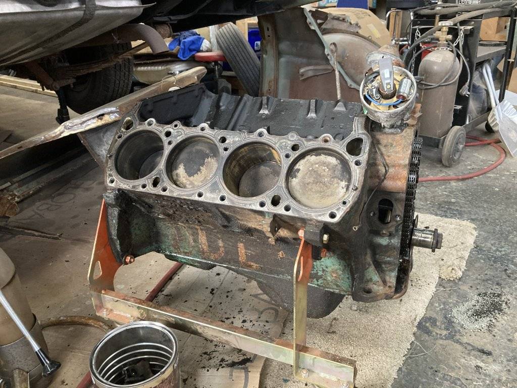

I don’t currently have the room to tie up the shop for an engine rebuild. I already have a trans fresh and ready to go and as luck would have it I now have a 440 with far fewer, around half so it will be perfect for a transplant. It’s a ‘68 out of an Imperial(we won’t talk about its fate…:BangHead:) with less than 80k on the clock is what I was told. The car was rock solid and I bought everything that he wasn’t using and had not yet scrapped.
It was loaded into the van with a skid steer and I didn’t have the same luxury on my end in the shop so I had to separate the engine and trans as I unloaded it so one thing led to another and I was excited to see what I had to work with. The timing chain was replaced but otherwise it had never been apart and I think I will be able to get away with a hone, re-ring to freshen it up. The block was full of clean and green coolant and there was no debris under the valley pan and rocker covers. Since I already did heads and valve-train some 20k miles ago those parts will transfer to this long block and the turn around in my shop will be quick And hopefully soon.
View attachment 599178View attachment 599179

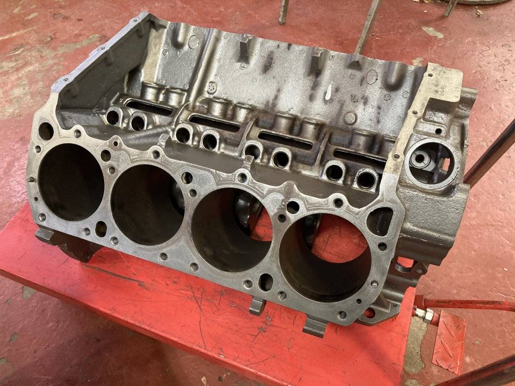

A quick update. I just dropped the 1968 engine block, crankshaft, and the pistons and rods off at my engine builder for whatever they need.:)
Well I was hoping to get away with a light hone and new rings but it looks like I’m buying pistons…:mad:
Otherwise everything looks great, the crank just needed a polish and will stay std/std for bearings.
