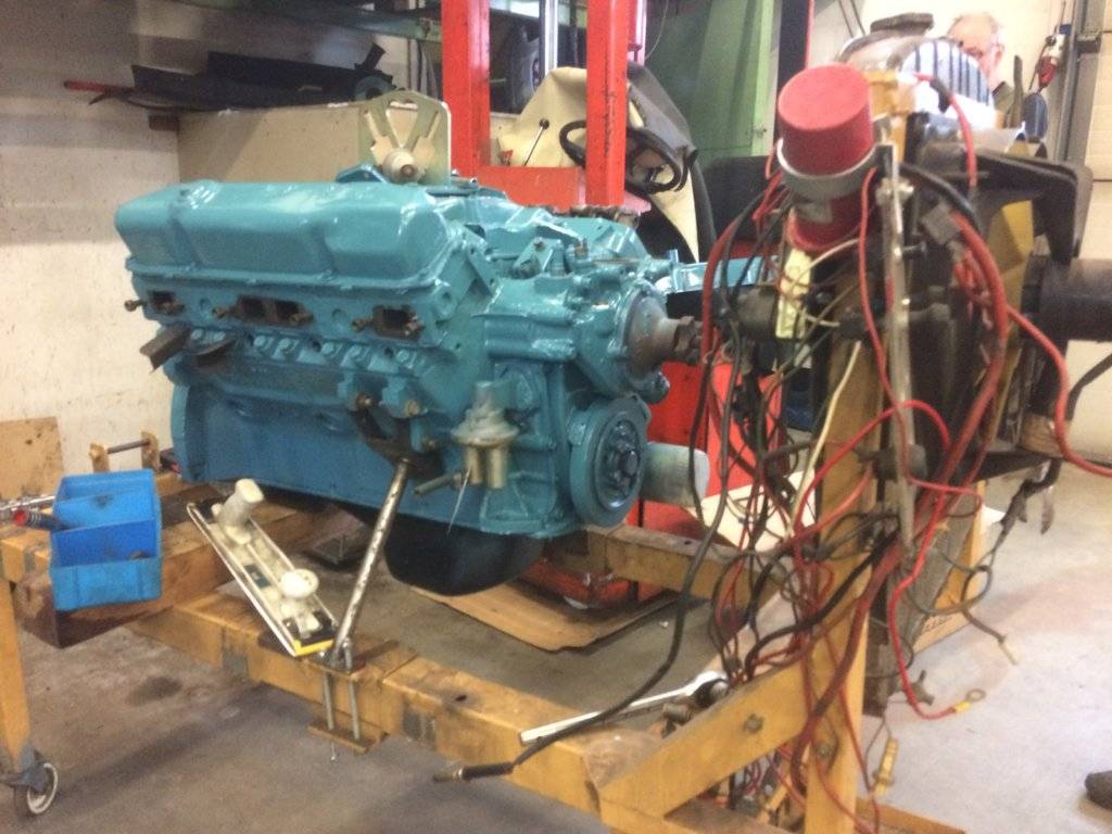

My engine builder is finishing up my 440, and it was time decide upon the carb. I reread the carb threads, but found zero input on this particular one.
The engine is a '68 block with a steel crank and stock 906 heads. It is supposed to be rebuilt to approximately the 440HP level: .030 over, light weight KB237KTM pistons to slightly above 1 to 9.0 compression, Edelbrock Performer Plus 2192 cam (204 int./214 exh. @0.50, range 0-5500rpm) for low-end torque, and Edelbrock Performer 2191 intake to complement. 440 source deep oil pan. A set of '70 HP manifolds will be put on it after the break-in run.
My initial idea was to use a Edelbrock 1406, 600cfm, or a Thunder-series 18054, 650cfm for a good response. However, my engine builder commented on the former being "a gas thrifting thing", and the latter that he had no experience on that one. He recommended a Holley Avenger 770 cfm (#0-83770, aluminium body).
Opinions or experiences to be shared?
Holley Quick Fuel is on my wish list. To be purchased and installed later. For now the goal is to make the engine run smoothly after ten year hibernation.

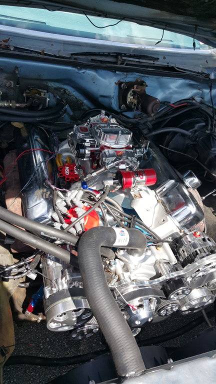

Another vote for the quickfuel. I run the SS-830 electric choke, mechanical secondarys on my 505/512 stroker in my 66 newyorker. It was fantastic right out of the box. Street and track driven
Another vote for the quickfuel. I run the SS-830 electric choke, mechanical secondarys on my 505/512 stroker in my 66 newyorker. It was fantastic right out of the box. Street and track driven..
12.80 @103 quite impressive!
What gear ratio and weight of the NY'er?
