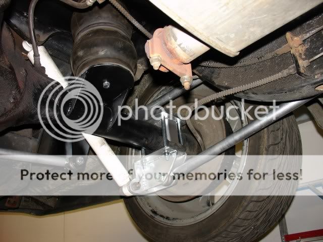

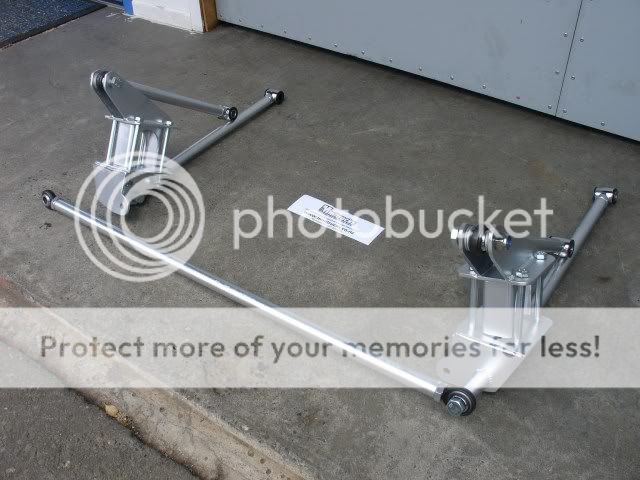

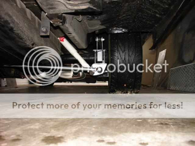

Hi there, we have a 4 link with panhard bar on our fury III, hooked up to airbags, altho could easily convert to coilovers, quite a bit of work, a lot of reinforcing in places. since this photo about 7+ years ago, the mount to the panhard failed, it was then double gusseted and havnt had a problem since
need to run very heavy duty shocks in rear to control the bounce airbags have, we now run rancho adjustables
