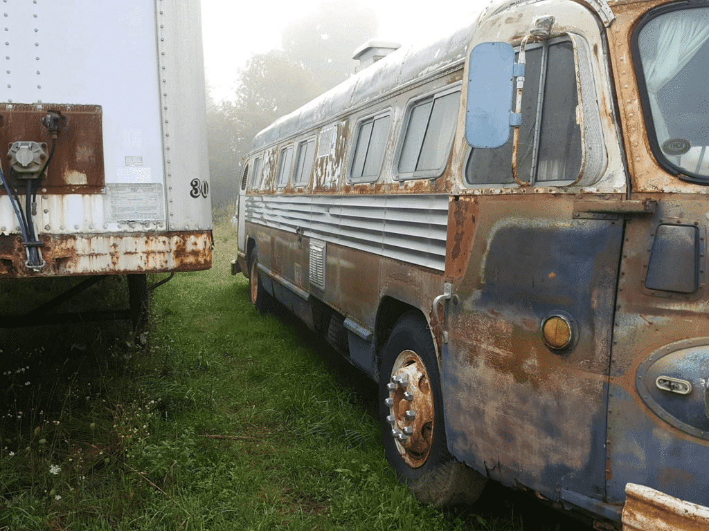

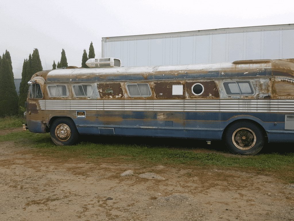

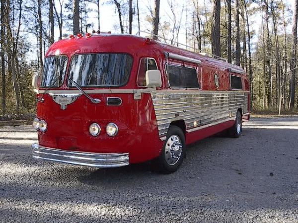

Here's a 1950 Flxible Clipper I almost bought.
The "devil I say"? Yes, really. I showed to a few members back then .. they beat me up purdy good about it .. had i fallen and hit my head, lose my meds, catch mad cow disease, etc :poke:

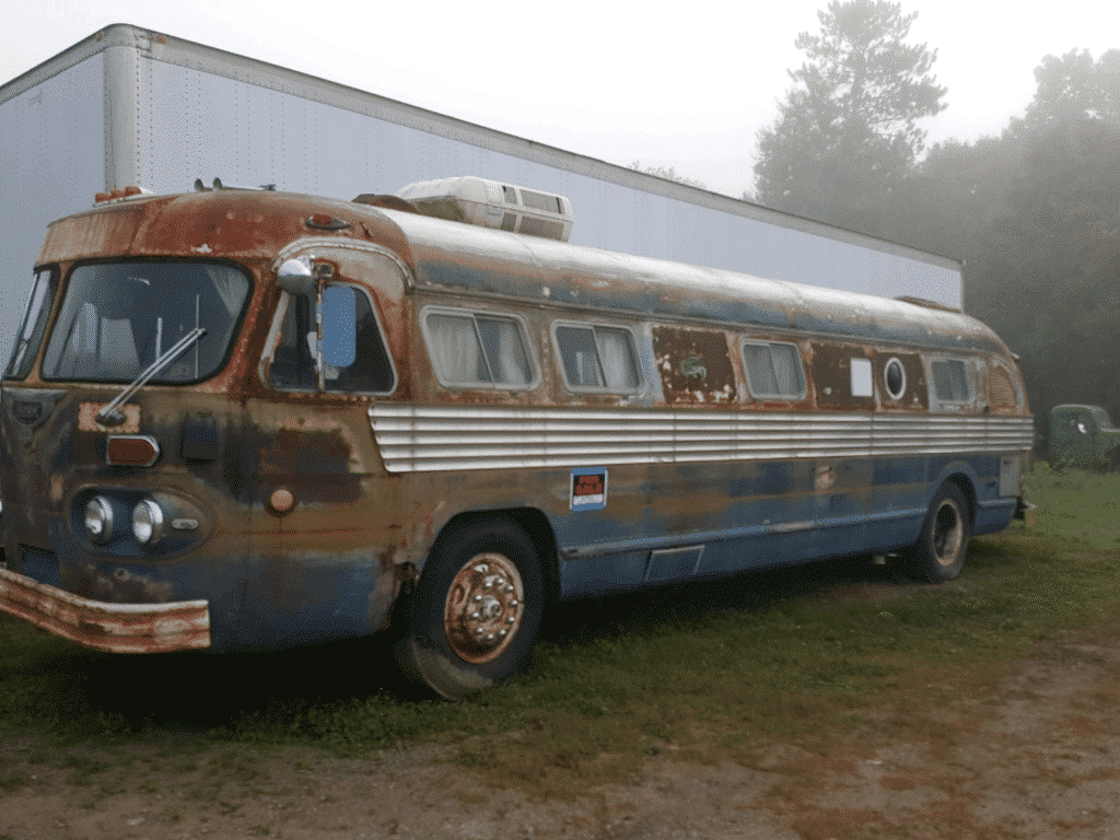

Yeah, she didnt look so good but was 100% complete (nearly -- lotsa unobtainium still on it), it ran but wasnt roadworthy, was UNDER $3K (cheap for a Flxie Clipper, even in this shape), and only 100 miles away from me so i didnt have to transport it.
was converted to RV in the 1970's and used regulary through the 1990s. Sat outside, however, in the NE USA, ALL that time. And hadn't moved since 2001.

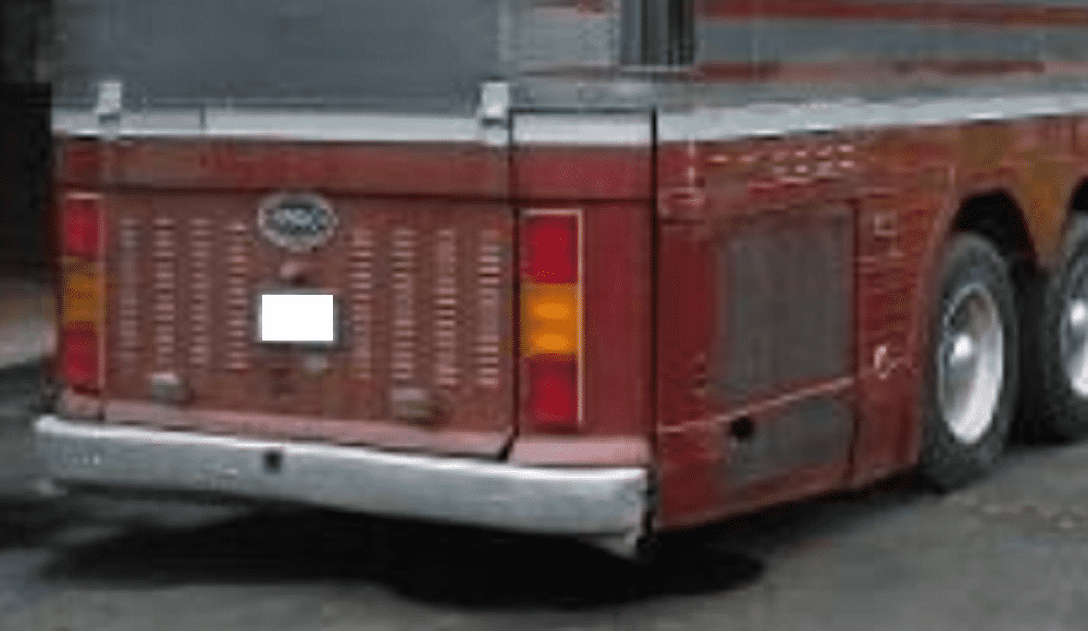

the magnificent rear end .. ton of metal patching/straigthening ... none of my guys wanted anything to do with that work.
This was September 2020 though .. in the middle of COVID action ... when I could not get anybody to work on ANYTHING. No even me .. the states I had to visit would NOT allow me in without quarantine first.
Anyway, I did NOT buy it .. not because some guys here beat me up .. but I concluded it was more for parts .. and particularly it meant I needed another one which i also DID NOT own (it would take at two to make ONE good one ... I will do it for C's, but NOT for buses).

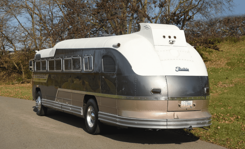

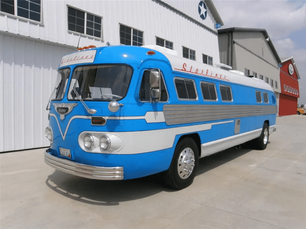

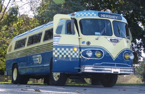

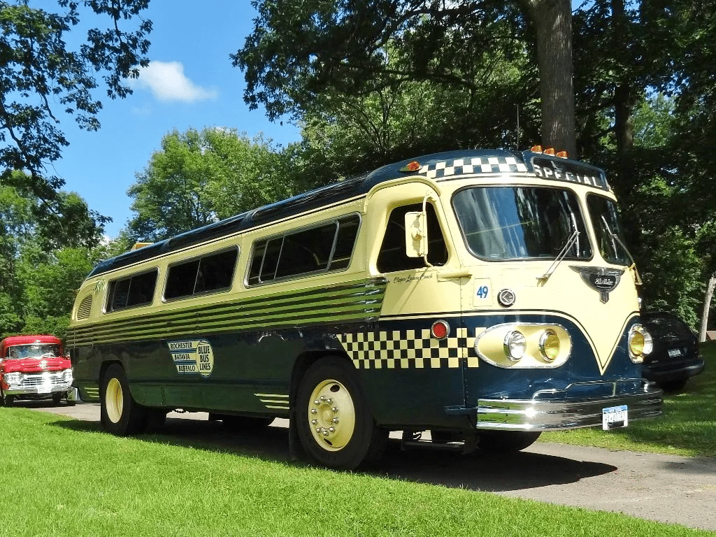

1957 Flxible Starliner. source : Where are the Flxible starliners. Other Starliners are featured in the link as well but this one stood out and excerpted below in a few photos.
The Shimer College bus when it was born in 1957, when a fella bought it in 2005, and then when he finished it sometime later. A job well done I say by someone who loves Flxies he says.
Tada! Man oh man .. thats nice!

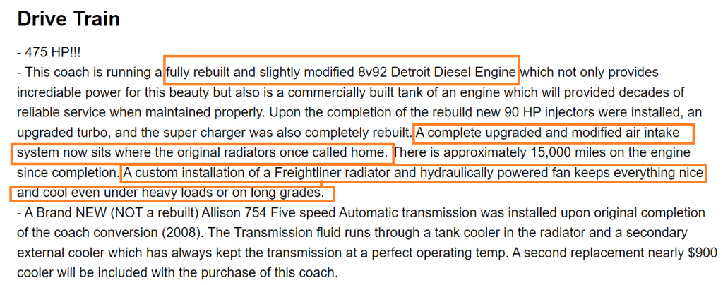

You could repower it with an 8v92, the 8v71's bigger cousin. Same great 2 stroke sound with 500 HP available depending which one you choose.
Kevin
Kevin I did get an 8V92 used piece, super and turbo charged.
Its sitting in my warehouse .. my Whisperer AND some folks I met from the PD forums loved the power but all of them had to solve overheating issues.
rebuilding (for the second time) what we believe (hard-part dating) to be the original 8-71 piece from the twin 4-71, dialed up with bigger(?)/stronger(?) injectors and other diesel lingo outside my expertise, we believe will make for good enough power, hill climbing with a trailer, etc..
IF it does not, I guess we do the 8V92 swap. Way back in post #46 Stan had me leaning toward a Cummins N14 "Red Top". The guys that did my 8-71 rebuilding are Cummins guys and were wanting to that swap too.
I finally and still do not intend to go with anything else but one of the Detroits (maybe even a Series 60 [yeah I know its a four stroke]) - I picked up one in a salvage MCI I bought for fitment parts couple years ago) IF the dialed up original iron ain't getting it done.

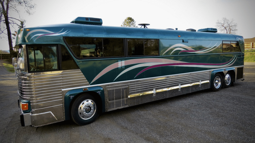

Different but related tangent .. there is an old 1969 MCI MC7 conversion on Ebay now. First I (and my bus Whisperer) like this bus and it really appears to be well done. Second, the asking price approximates my total budget for my PD 4501 conversion.
Somewhere in its conversion journey, it was pre-emptively/reactively modified for much better thermal performance/airflow through the engine comparment. I put vintage stock photos in first to show how the MC-7 looked back in the day.
We estimate several thousand $$ spent .. even cutting louvers (in the new panels) where there would not have been such a thing originally. Our conclusion is it was well done, albeit probably pretty pricey. Nice coach tho.. we think somebody will get good it they picked up this baby.

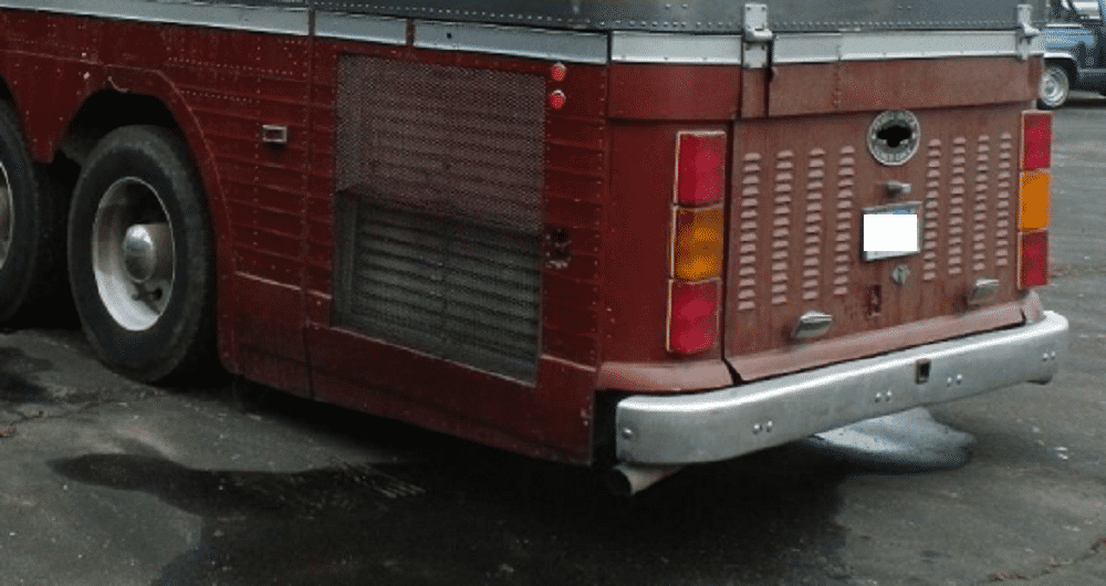

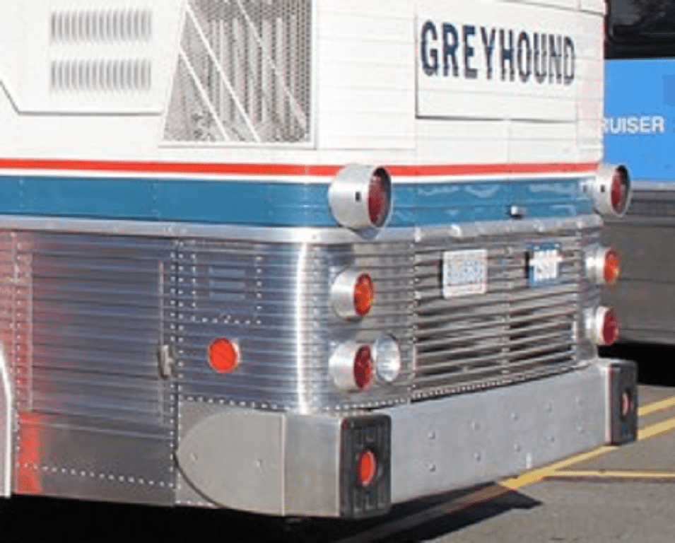

Two secs of background. Recall 4501's originally designed for TWO 4-71 DD's .. that was a disaster, so they all got repowered with a single 8-71 (introduced by GM in 1959) starting in 1961. B oth configurations were "T-drives" with engines longitudinally mounted.
They (Greyhound, GM, and the repower guy Marmon & Herrington) then switched to side-mounted radiator (yeah, radiator was opposite the LH vehicle side cylinder bank of the 8-71, presumably because they HAD to have room package the bigger/heavier 8-71).
The 4-71s had fans on the front of the backward-facing engines, getting air from rads in the back doors (see photos below) of the engine compartment.
So, how did they drive the fan with 8-71's ? Off a belt, but with a shaft, to a "gear box" (see photo below - not mine but a 4501 with 8-71). Over time, the gear box wore out. The radiators (if well maintained), tended to hold up pretty good is what everybody says.
Remedies coming into view: My jaws are getting tight as I write this. Might take a few grand to fix this... within the "contingency" of my original estimate, but still ... I'm only 40% done on this sum-gun.
:mad:
OEM fan gear boxes/drive mechanisms: are in the "unobtanium" parts bundle. Impossible to find in usable condition, original manufacturer MAY (gotta check this) still provide the "guts" for somebody else to rebuild the gear box. Round numbers? $2K for parts/labor to rebuilt the gear box
OEM Radiator: Dunno -- still working on it. Pressure/chemical clean it again, going "tube by tube" (not sure that's possible/cost effective) looking for obstructions. Decent air flow (they estimated pressure drop) THROUGH core suggests fins are doing ok. Slow/low fluid movement THOUGH the tubes suggests obstructions however. A OEM rad for it impossible to find.
A core replacement from a class 8 truck, OR a custom aluminum core, may be possible/necessary if original piece is still underperforming. Cost? TBD$ but probably $2k for that too
Airflow though the compartment. Since there is NO longer a big, thick condenser on RH side of bus (OE AC system waa gone from when bus was gutted), is essence a big hole in the wall to put some electric fan(s) to try to help moving hot air out of engine compartment (or auxilliary heat exchanger(s)).
Last ... just found on internet. 4501 RV conversion, 8-71 rebuild, but they cut louvers in their back door. Seems like thermal mangrmrnt is a challenge as these coaches age -- some of them at least.
