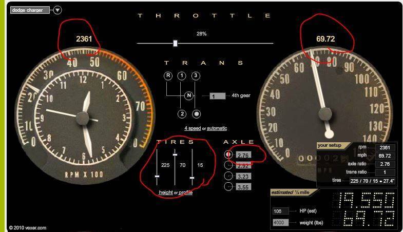

As far as the rear goes, how can I check what I currently have if I can't tell from the fender tag?

You are probably pretty safe in assuming it's a 2.76 but maybe not
Might still have the tag on the rear end nuts holding the chuck in, you could jack it up and rotate wheels and see how many times the drive-shaft turns (can't recall if that works for autos) , if you have a tach you could drive a steady speed and compare the RPM to one of the online tools that tell you all kinds of things. I'll post a link later
You could pull the diff out and see what's stamped in the ring gear, and you could pull the speedo gear and tell us the color / how many teeth, probably something i'm forgetting
It is a 8 3/4 rear right?
Here it is .. the needle's a little off so look at the digital number for RPMs
Lot's of adjustments in this tool
http://vexer.com/automotive-tools/speed-rpm-calculator
That is awesome, thank you! Now I wish I had a tach! I will try to crawl under and look for a tag. I do not know what size the rear is, still learning a lot about the car. I think the speedo gear might be the quickest for me to check although I believe the rear is weeping a little bit so maybe I will check the stamp on the gear when I pull it apart. I'd like to know before I tear anything apart though so I can source a new one if need be. Or maybe I just bite the bullet and install a tach which I would love to have just don't like the idea of screwing in aftermarket stuff in the interior.
