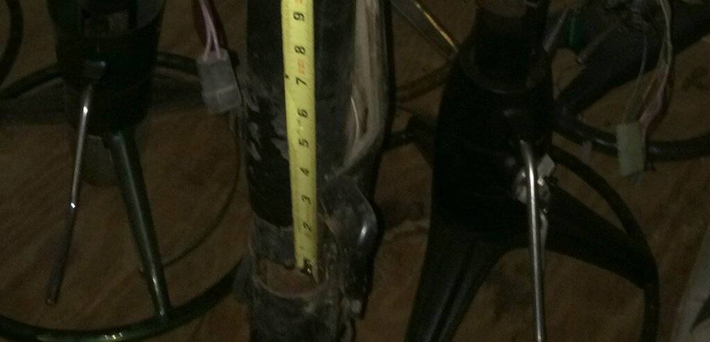

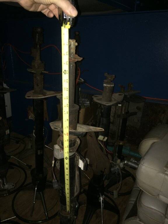

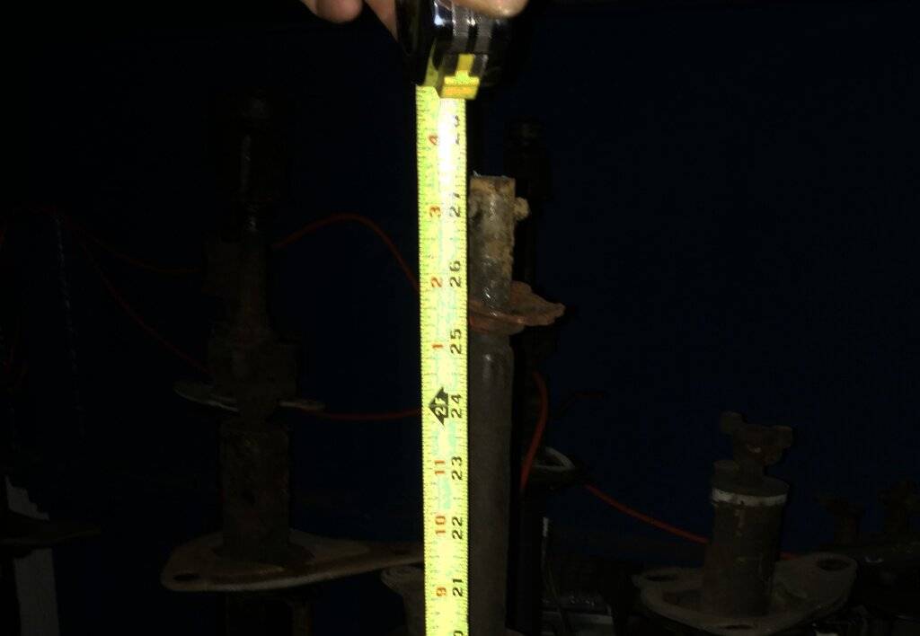

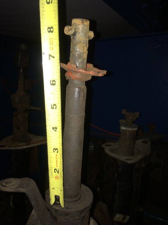

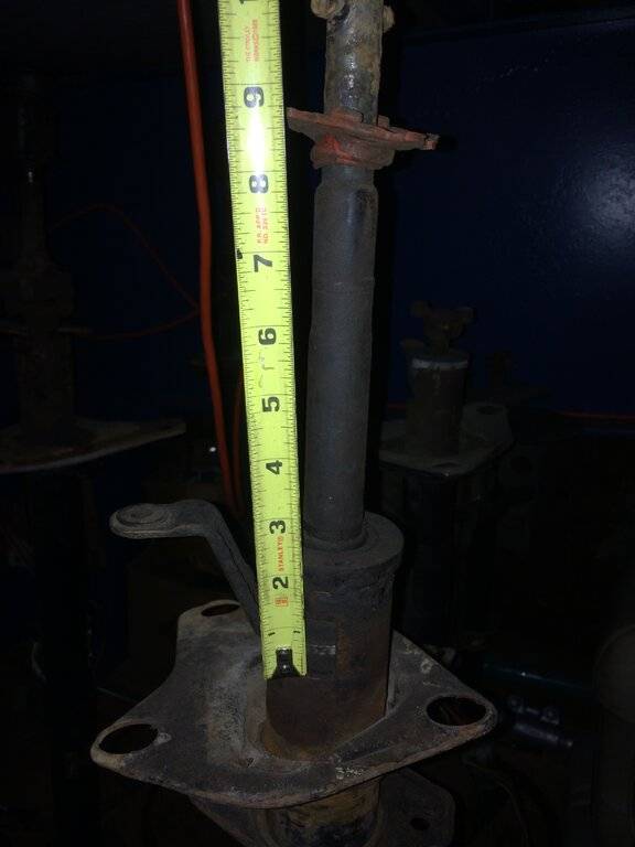

Here's some photos. Let me know if you need something different. I tried to pick a few different reference points. It's kind of dark where the column is, so they aren't the best.
It's about 5-3/4" from the surface of the bearing retainer to the step in the shaft.
With the tape measure resting on the shift lever slot, the side that's closer to the steering wheel, it's about 7-7/8" to the step.
With the tape measure hooked in the slot near the mounting bracket, side of slot further from the steering wheel, it measures a little less than 25" to the step.
