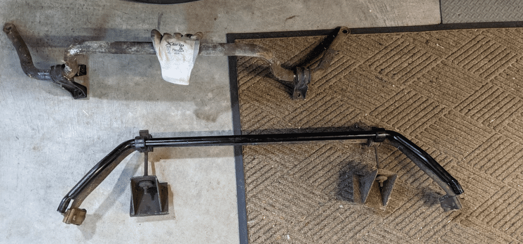

Years ago when I was young and new. Mostly one bar fits many, maybe. Rear hangs low off axel. If you alreadt have a sway bar, the Addco is not much bigger than stock. My vote is no.
I agree they aren't much bigger but the way they locate and control movement is way better than the floppy sloppy way the current one works, sliding left & right along the sway bar is rubbish.
The '72s did not have factory rear bars, C-bodies that is. ADDCO and Helwig were the main suppliers of rear sway bars for everything in the 1960s and 1970s.
Chrysler allegedly did not like rear sway bars, although GM embraced them in 1969 on Caprices (F41 option) and Pontiac a year or so prior on the GTOs. On those earlier systems, the front bar was not up-sized when a rear bar was installed. BUT when radial tires and the then-new '73 B-bodies also arrived, there was a HP suspension option which had Goodyear radials and a rear sway bar. "Radial Roadability Option" on Road Runners, as I recall, PLUS 15x6 W23 Class II 16-Slot road wheels were a part of that package. Not unlike what later appeared on the '75 Cordoba/Charger SE cars, plus the B-body police units.
A friend installed a '76 or so Cordoba rear sway bar on his '66 Polara 2dr ht. Said he had to heat the bends a bit to make a sharper bend to mate with the '66 C-body rear spring pads.
I suspect a '74-'78 C-body rear sway bar might be a closer fit, considering the tread width similarities on the Fuselage cars and the Formals?

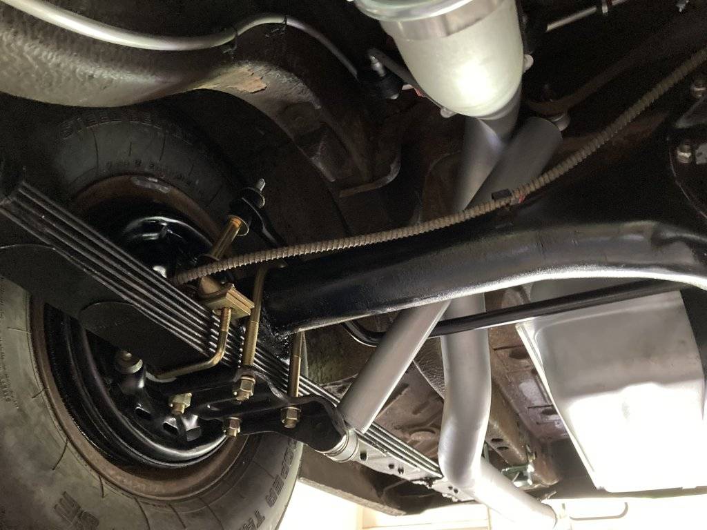

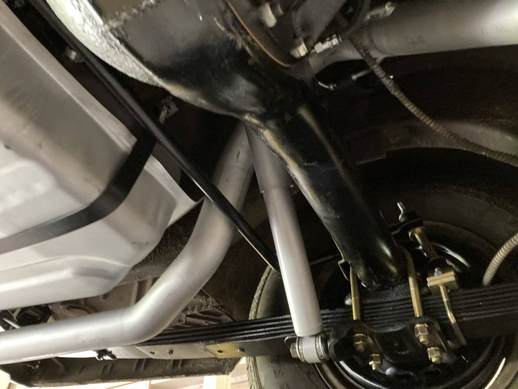

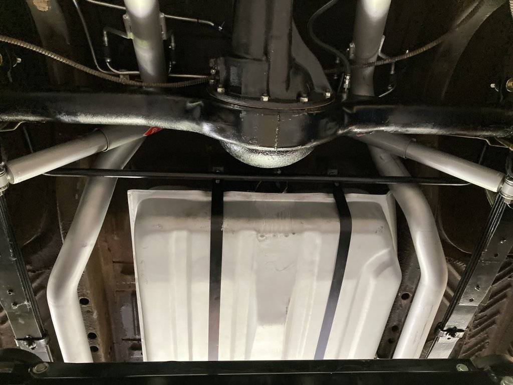

I have front and rear PST sway bars on my '67 300 and love the improvement in handling. The car goes where I point it with no body roll.
67 300 convert...maybe i'm crazy but i dont see where your rear bar attaches to the chassis...it looks like its just attached to the links and hanging in front of the exhaust
Me either. Looked up the pst instructions, should be mounted to the frame rails…

Seriously...so glad I posted the photos and you guys caught that. It needs to be corrected. Thank you for saying something, volksworld and Mr Mopar.

When I saw that picture, with the clamp going around and touching the leaf spring assy directly, I frowned at that method, without some rubber in between the clamp and spring. A "wear area" on each edge of the leaf stack, not good to me, as presented.
Seems like the old Helwig bars had a u-clamp that went around the axle tube? As the OEM rear bars have links which attach to the lower shock mount plate.
mine had an unknown rear bar that's been in it over 20 years...it wouldn't clear the new TTI exhaust (2 1/2) where it turned down behind the axle...i would have had to put spacers at least 1/2 inch thick between the brackets and the frame rails to use it...will probably attempt to make it work when i install the sure grip but have too many other things going on at the moment to get involved...so i took it out ...seems like the TTI pipes play better with the sway bars that mount in front of the rear (with the big bend in them to clear the diff)
I've tried the ADDCO rear bar 2 times in the past, probably over 20 years ago.
Never could get it to fit any-which-way, on both a Fusey and a Slab.
When I saw @67_300_Convertible 300 s bracketry on the springs, I thought 'hey, that's an ADDCO bar, how did he do that?"
My memory is that I could not locate the bar, whether above or below the axle, or pointing forward or rear - no way to get the endlinks close to vertical.
The length of the bar's arms always put the endlink location right at the axle.
Maybe the bar could mount on the axle, but that would require hardware they didn't provide.
