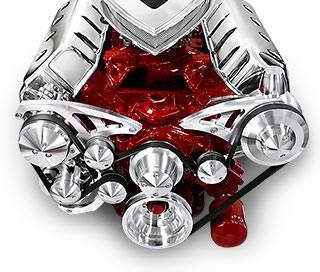

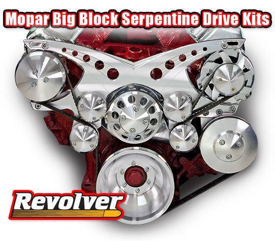

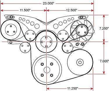

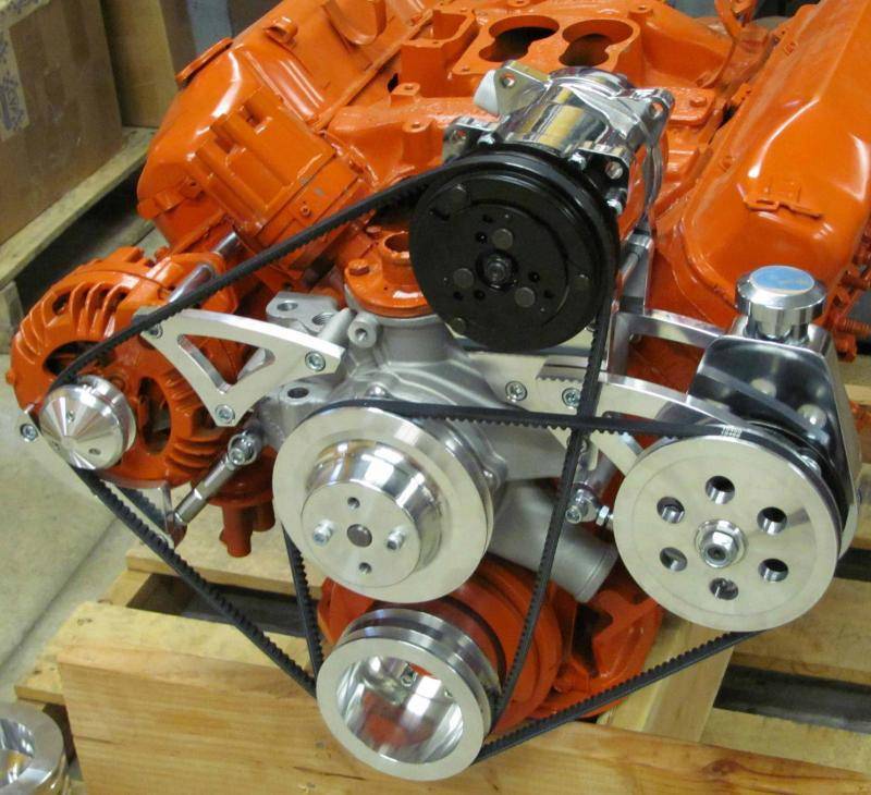

How's this for engine brackets? Billet 440 V-Pulleys Set-Up   CVF Racing.jpgchrysler-hemi1.jpgMarch Serpentine Pulley System.JPGMarch Serpentine Pulley Measurements.JPG

Yes and that is the one's I am using but I am going to the factory pulley's and we are going to try and make a new bracket for the factory pump. I think we can do it and it all look really nice. Can't wait to see how it turns out.
keep us updated on the setup you go with. they are cheaper than march and seem to have quality parts. so good quality parts at a good price are always good.
Stan, that is another reason I am using the factory pulleys. There is two belts. That being said I have used a single belt on many of cars and had no trouble. You just have to make sure you have good alignment which you should have anyway and you use a good belt. Believe it or not one of the worst belts I have ever used is the Goodyear belts. Use Gates! They do not tend to stretch near as much as any of the rest. The Napa belt is also a very good belt. Going to call CVF here after a bit and see what they say.
That CVF setup uses a double pulley AC compressor,just wondered why they didn't space it out further and use the double pulley setup on the alternator too. I've used single pulley systems with no problem but it's always nice to have that extra belt as backup,especially when it's running two main components like Alternator and AC. That's got to put a heavy load on that belt every time that compressor clutch kicks on and off.
