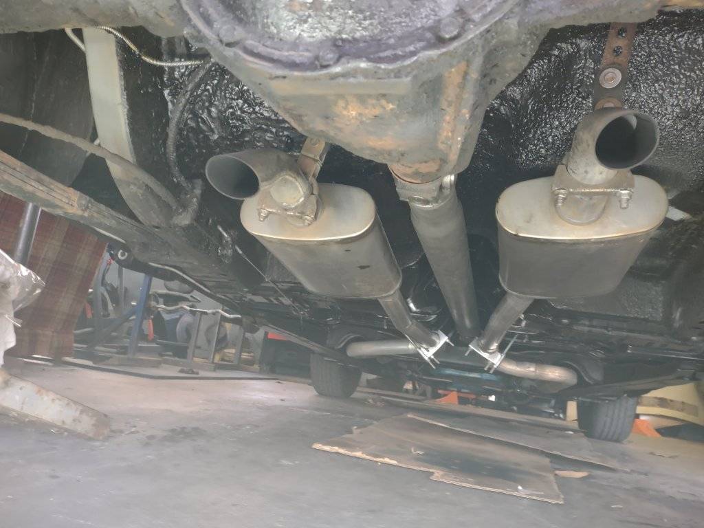

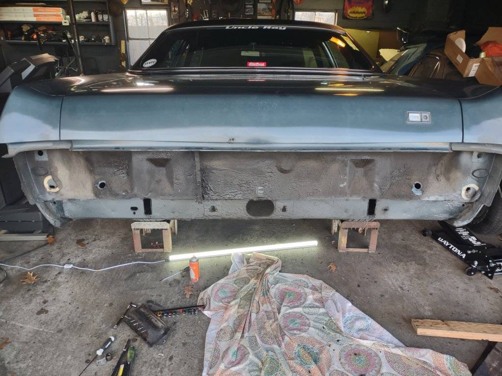

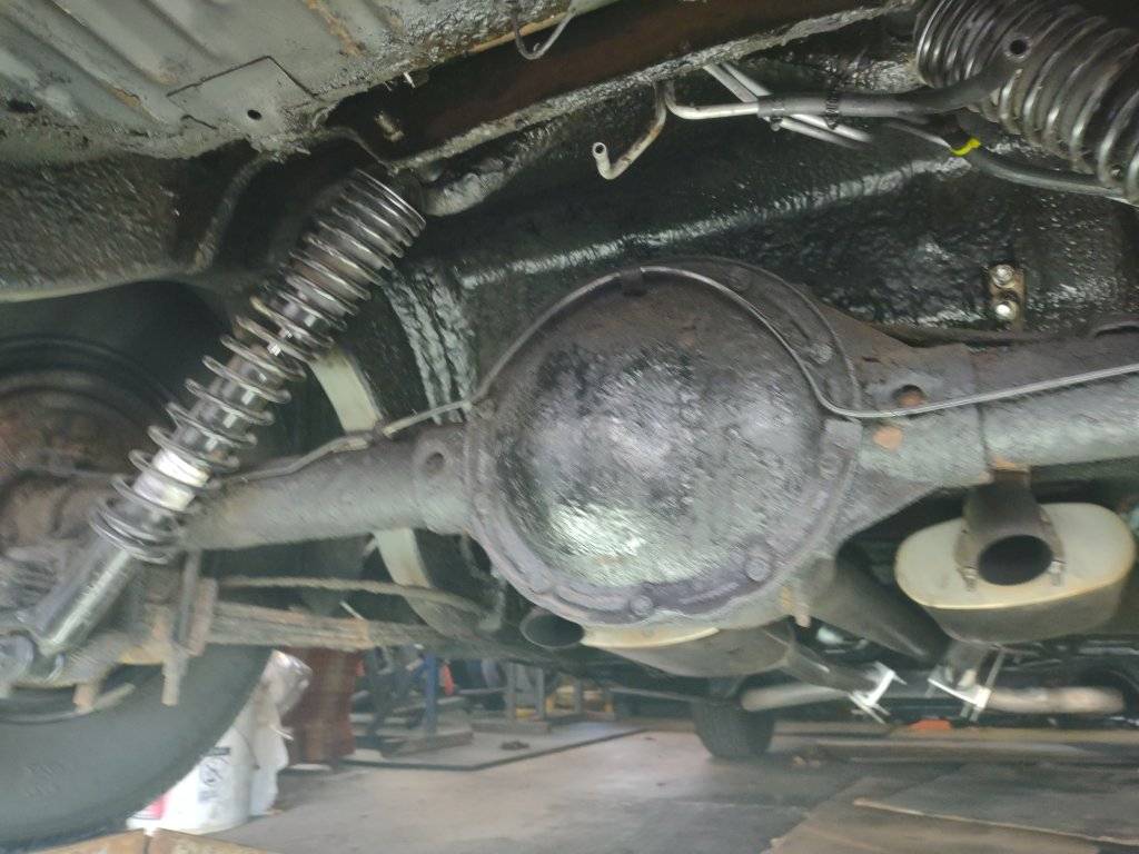

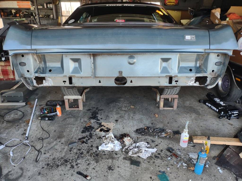

Decided it was time to park the Fury even though it's still very nice here in western pa. The plan for this winter is to get the sludge cleaned off of the bottom again, patch a few rust spots, clean up the rear end and put new leaf springs on. Started heating and scraping on Friday and I'm already sick of that ****, so I'm looking into renting a hot pressure washer this week and blasting as much of that slop off as I can. Thankfully a lot of it is still soft so I think that will make easy work of it. Also, I knocked out the filler on the panel behind the bumper to somewhat legitimately repair the rot. Would anyone have a pic or two of the front and back side of that panel so I can have a good idea of what to do.

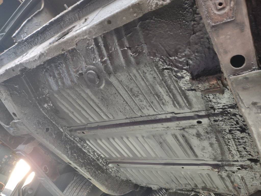

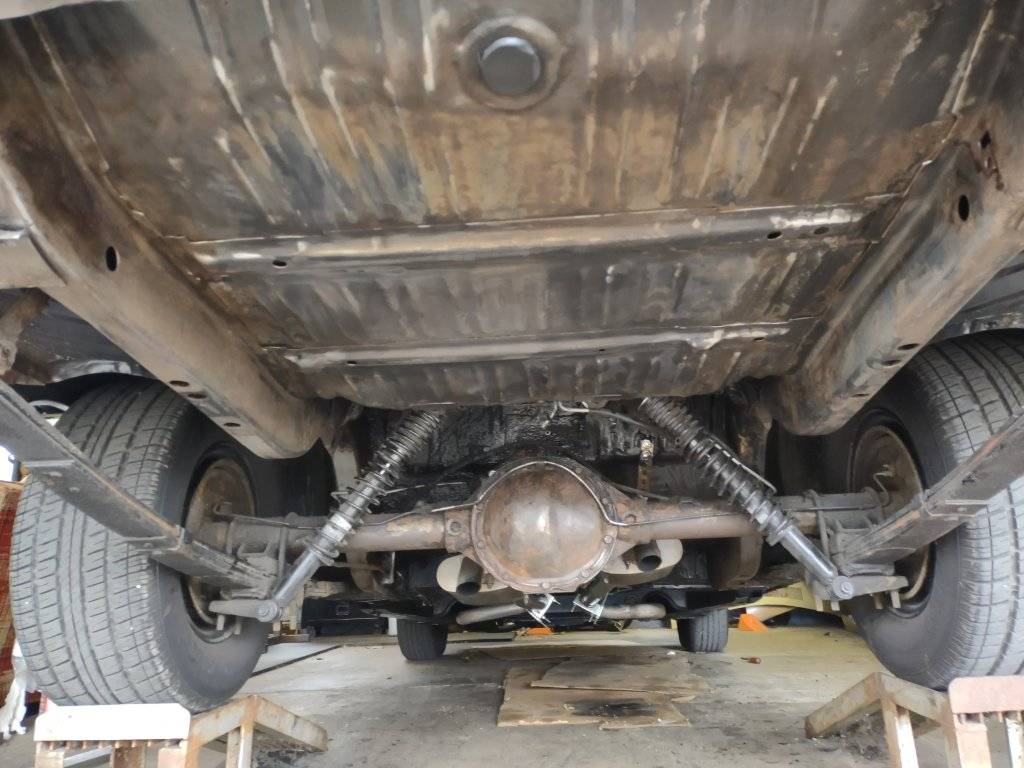

It's definitely not factory and recent. It's ziebart-like undercoating that's was slathered on there up until the late 80s when it was parked. Believe me the job is a pain in the ***, but the back half has to match the front. Most of it is still soft, but there are areas where it has gotten hard and needs to go. This is what the front looks like (crappy pic) after months of scraping and scrubbing with kerosine/mineral spirits.

I had much success using Simple Green in large quantities, with a nylon toothbrush, plastic putty knife. Gallons of it, on my 65 Mustang. Yes, dirty job, but the simple green didn’t affect the paint underneath and in fact, I uncovered the factory grease pencil marks that the inspector placed on the inside of the fender wells.

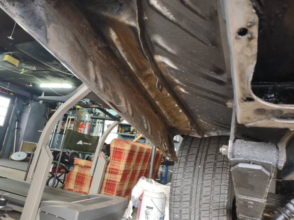

So far this is cleaning up nicely. Found a few small rust holes under the slop, but they're small enough I should be able to clean them up and glob some weld in them. Not like it's going to Barrett Jackson auction anytime soon and a little weld is better than filler IMO. Happy Thanksgiving everyone!

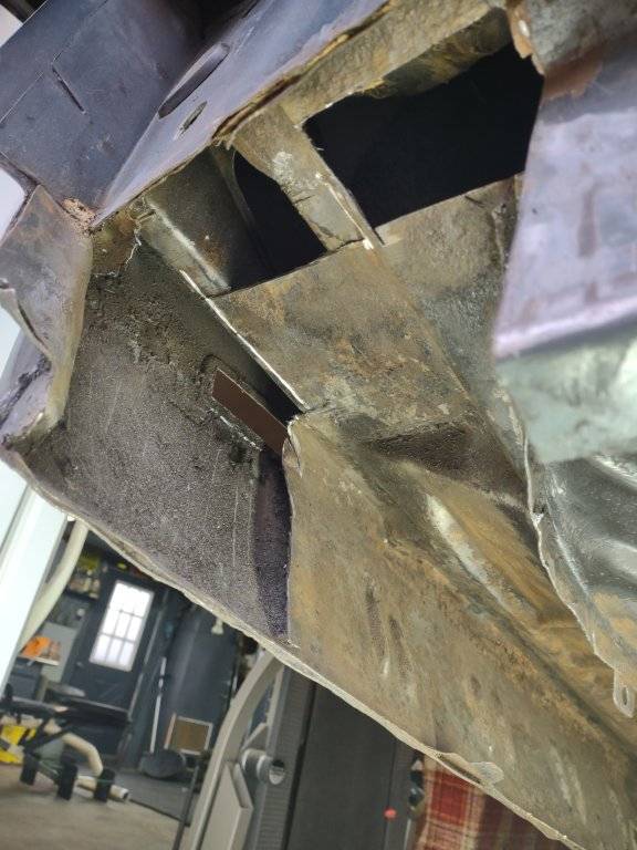

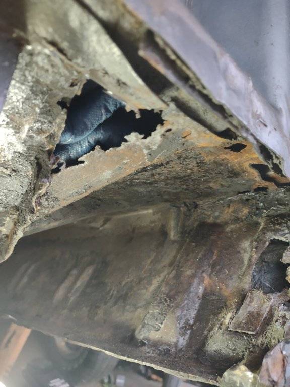

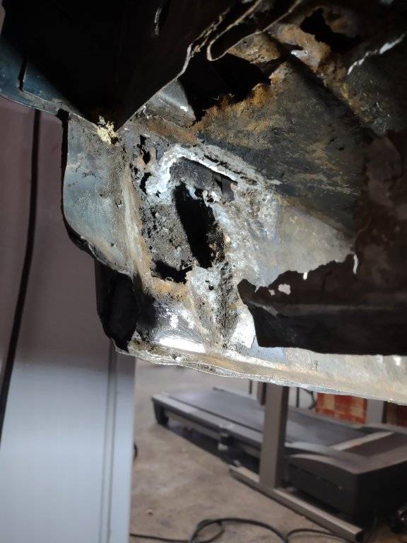

This turned up after I knocked the rest of the undercoating off the inner quarters. The passenger side is in similar shape but not as bad. I'llcut this out and patch as best as I can and won't complain too much since this car had never left western PA.
