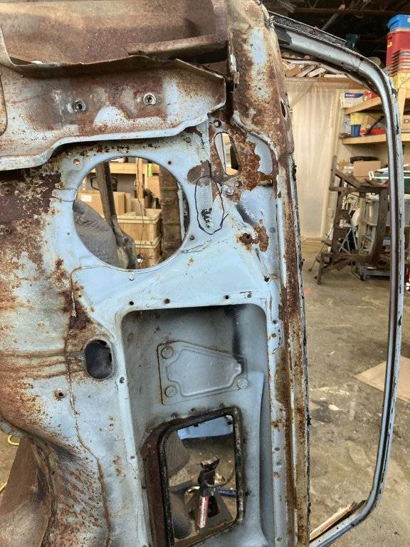

SO Number on firewall is circled in black on a ‘66 Imperial.
No other VIN stamped anywhere. There probably is another SO number stamped somewhere, I don't know where.

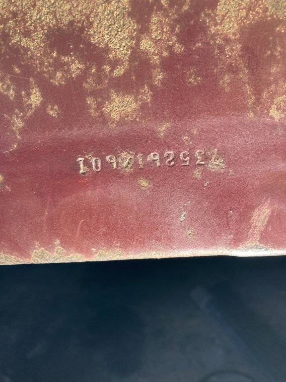

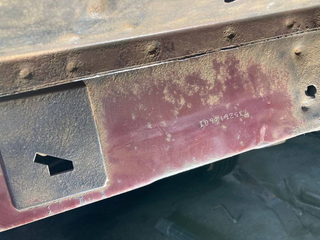

On my '65 Barracuda, there is an SO number under the rear seat area. That SO number would also be on your fender tag.
One of my 65s had SO# stamped on top of the cowl (in front of the windshield), mostly covered-up by a piece of rubber molding. My other (pretty much identical) car had nothing at all in this location . . .
Don't remember for sure, so don't quote me . . . but I thought I read somewhere (years ago) that there were maybe 5 "secret" locations where they might stamp the SO#, and they'd randomly pick 3 of the 5 locations to stamp. Another place I think I've seen stamped is along the trunk drip rails . . .
