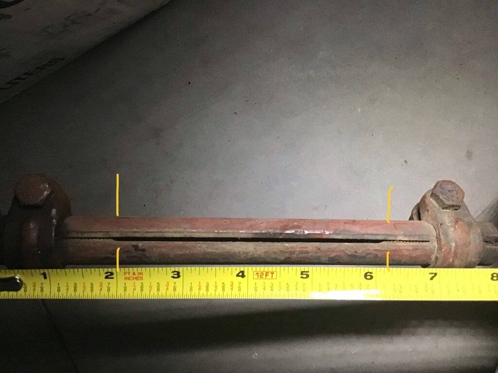

The gap with no tie rod threads is 4 3/8” on a B-body. They don’t come to 1/2” of each other at all. I tried to show in the phots, I put yellow lines at the ends of the threads I photo #2.
These sleeves are tough, how many fail or bend? Very few.
