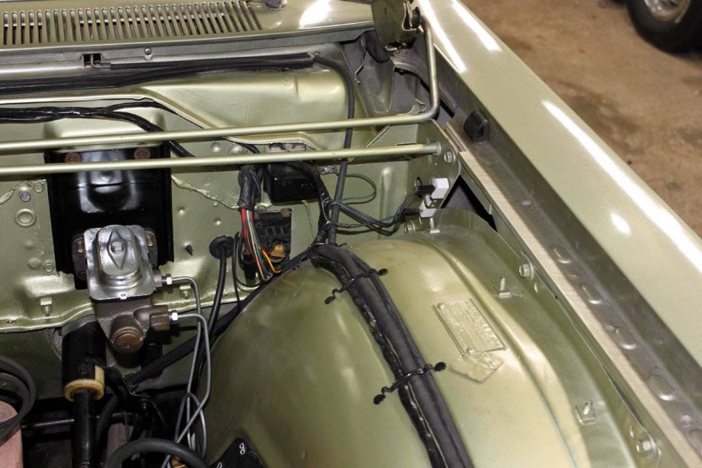

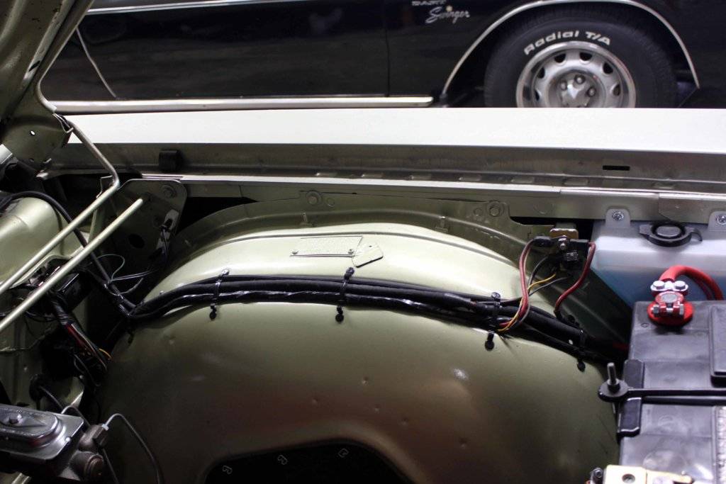

The path is along the driver side inner fender under the bonnet, exiting from the firewall, for the majority of the wiring (some split off and run along the inner firewall). You should see the bulkhead near the brake booster. There should be some holes about 5cm apart, down the length of the inner fender, where loom fasteners snap in.

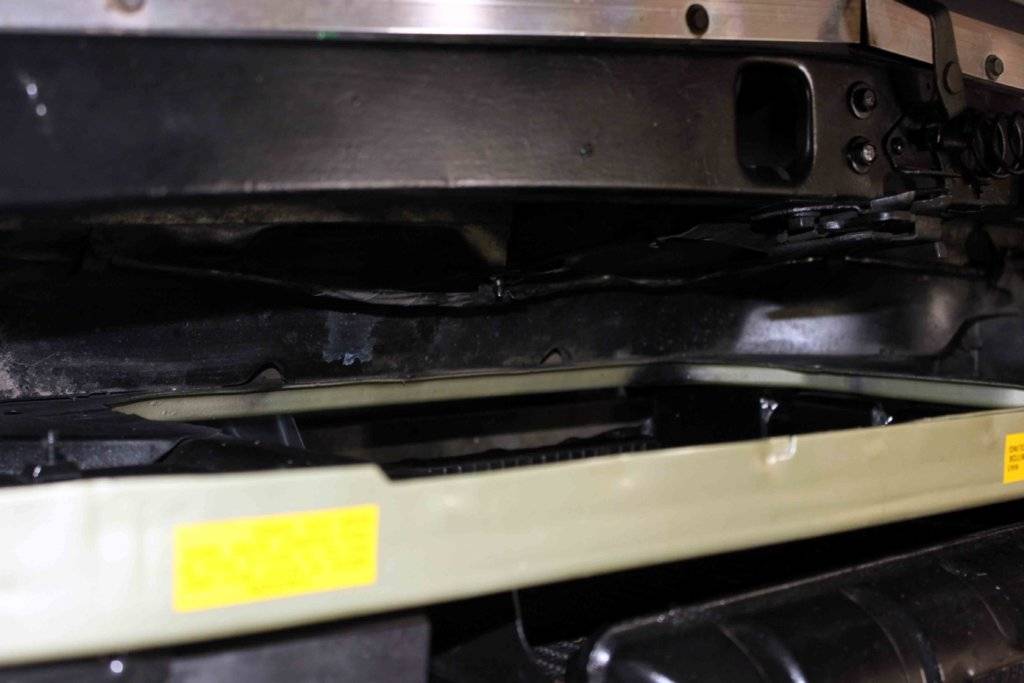

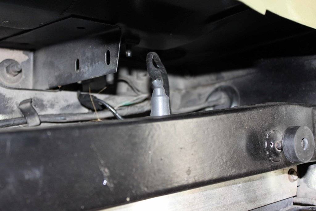

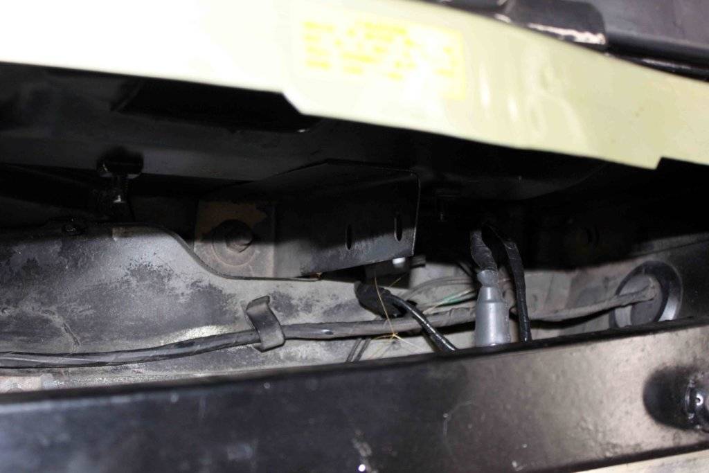

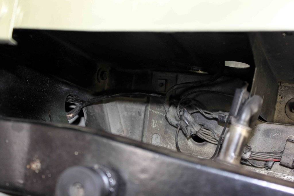

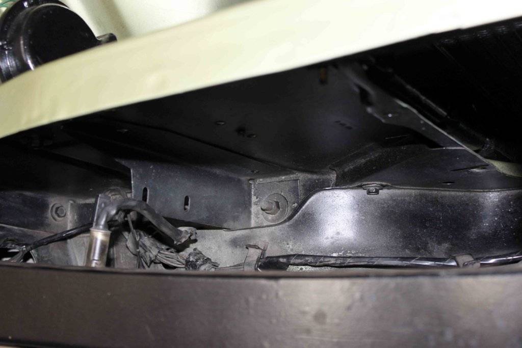

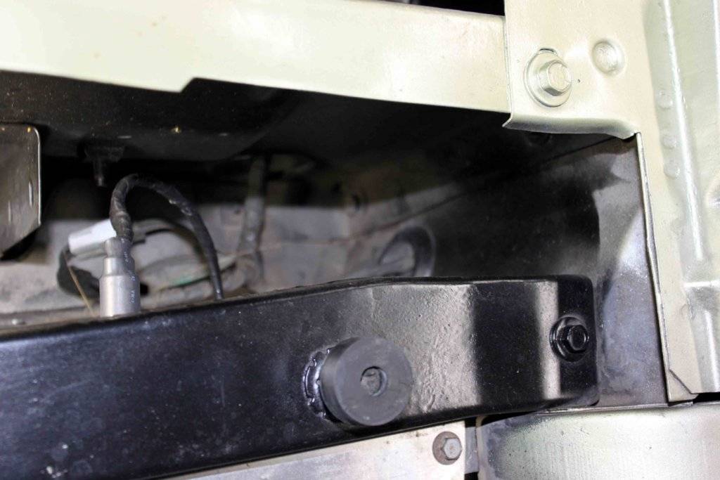

The area I need to sort I think is known as the gravel pan and its the loom from one headlight to the other if that makes more sense
Here are some pictures of my 68 Fury Convertible.
The pictures in the area between the grill and the radiator didn't come out as clean as I hoped. With the flat black of the paint and the black of the wires, it is tough to see the detail. I used a drop light it and whitened the pictures and lost the contrast. Hopefully this helps you some. If I can figure a way to get some better light, I will take a few more pictures.

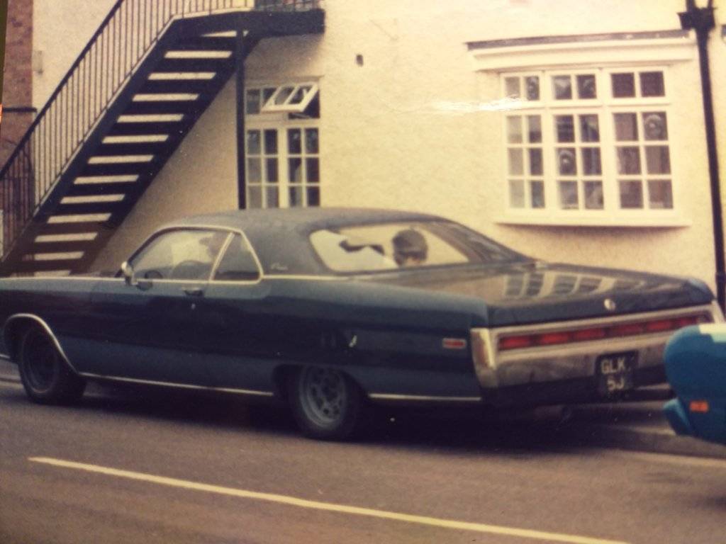

Currant pic of the Fury, it may look rough but we have done a huge amount of work to it, at the time no one wanted it, badly damaged so it would have gone to the yard. When we applied for a V5c for it (your title) when it arrived I noticed the license plate only to discover I owned it 15 years prior . Factory 440 car. I will uncover it and take better pics.

New windscreen fitted at massive expense, one of the dearest things we have needed to get (we have been looking for side drop glass' for 4 years for it, so they may prove dearer LOL)
