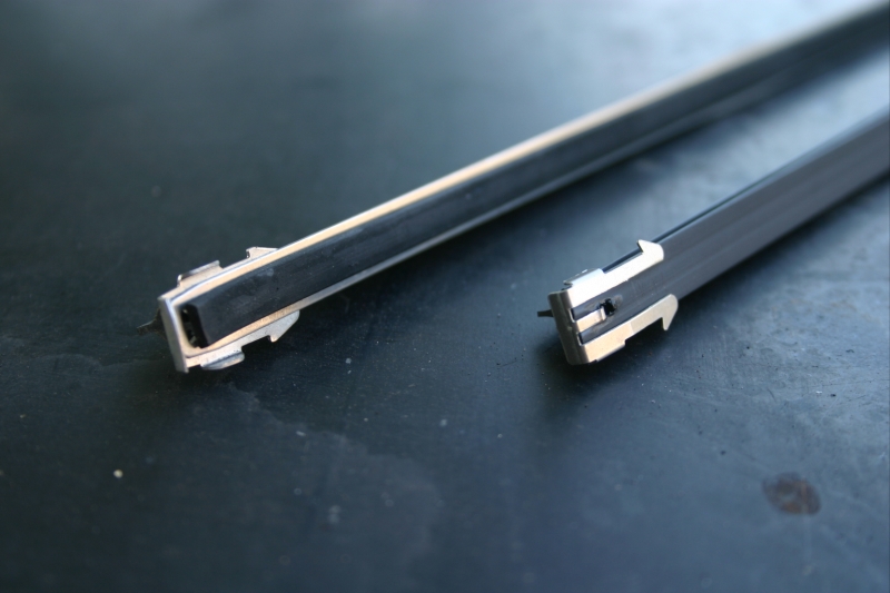

I'm sure a lot of store have them IF you know the number or are willing to sort through a pile of different ones of the correct length. They have no way of looking them up!
I went to O'Reilly and they had the 44-160 and not the 43-160 (Trico)
I went to Car Quest next and they had a 453-160 that was correct as well, their other number was 454-160
The 43-160 is the correct vintage style with the metal frame. The 44-160 will work but has an integral plastic frame, otherwise the same.
453-160 on the left, 44-160 on the right.

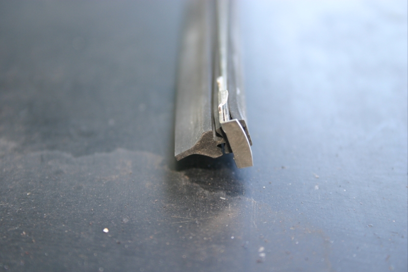

Close up of the Car Quest 453-160

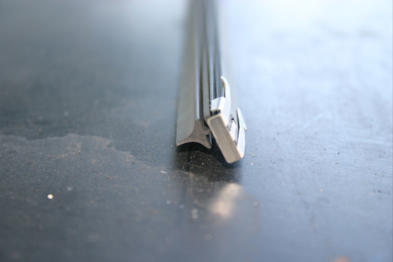

Close up of the Trico 44-160
Both have been tested and work.
I have not located the other two numbers but in time I would like to see if they will work.
So the list that is good
Correct metal frame style
Trico 43-160
CarQuest 453-160
Functioning substitutes
Trico 44-160
CarQuest 454-160
Alan
