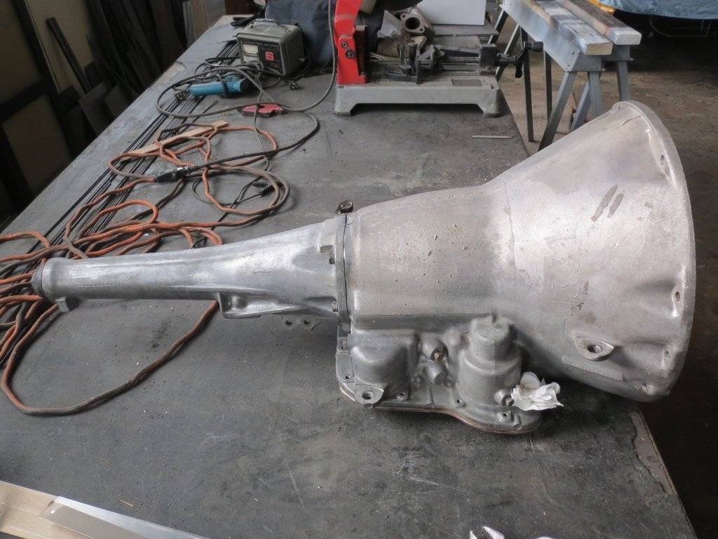

Transmission accomplished!
Here are the highlights
Here are a few of the improvements made to my trans. I found a used late '90s 46RE on Craigslist as a doner for some of the mods. The valve body got a shift improver kit and the oem steel check balls were replaced with the composite ones from the 46RE as they don't beat up the separator plate like the steel ones.
New TCI HP intermediate sprags.
New style dimpled input bushing in pump housing for improved oiling.
Replaced main output shaft bearing.
Back planetary set was replaced from the oem 3 gear set to the 4 gear from the 46RE.
Front clutch pack springs went from the 9 originals + 3 reds from the 46RE to = 12.
Front clutch pack bushing replaced with new updated grooved style for improved oiling.
Front clutch pack discs changed from 4 oem to 5 Alto-red .062 discs.
Back clutch pack discs changed from 3 oem to 4 alto-red .062 discs.
Kick down apply lever changed from 3.2 oem to 3.8.
New front and rear bands, good ones.
6 1/2" washers used as blocker in the low/reverse apply piston assembly.
Removed casting flashings from case(one was dangerously close to falling off which would have been disasterous)
This was all done by a close friend of mine whose a guru imo and I'm really looking forward to experiencing the performance of this trans.

Sounds like you picked the right guy for the trans job. The 518s seems to shift better than a 727, the mods you described must be why.
Impressive job for an impressive car.
How to make a bullet proof Torqueflite just using in house parts. I'd put that in a 2016 300 if they'd offer it.
I told him I didn't want violent shifts just a trans that I would never have to touch again. I know it's going to shift harder than a stock trans though. A faster, crisper shift means less friction and heat.

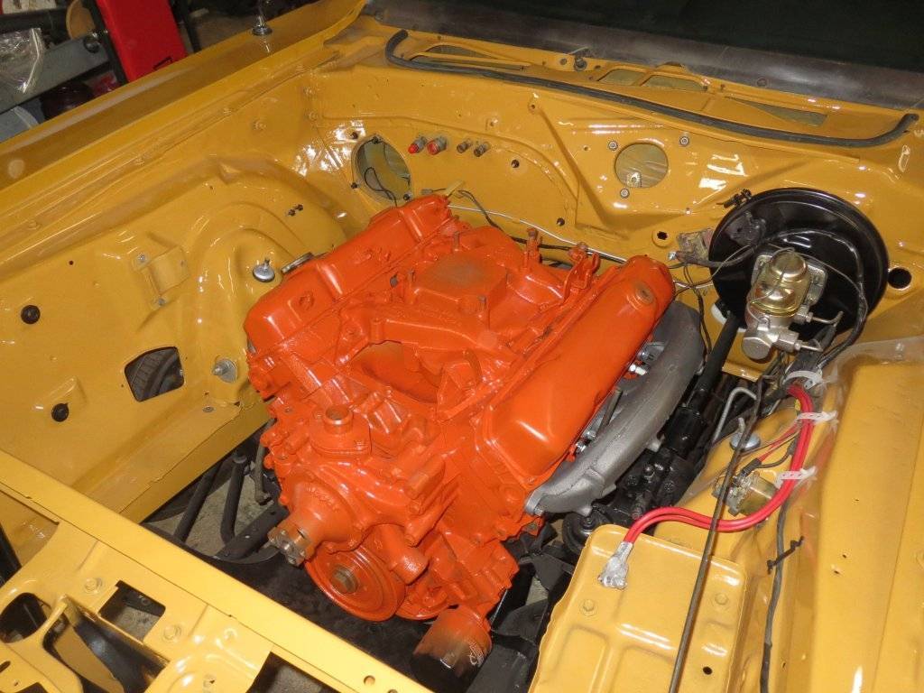

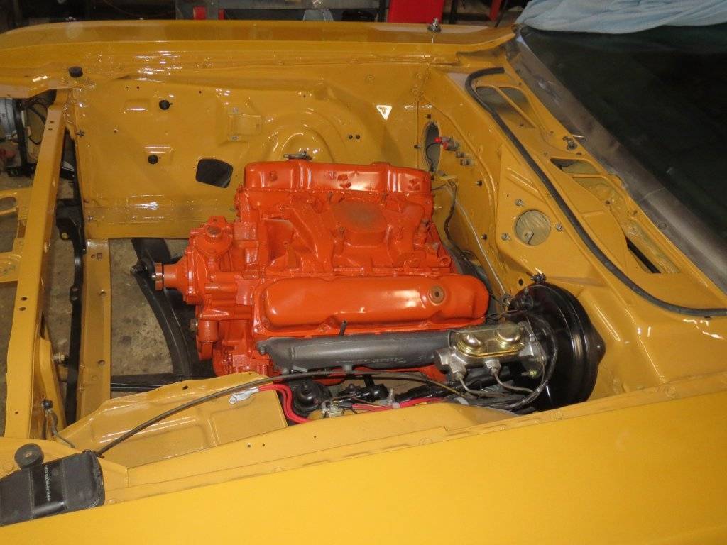

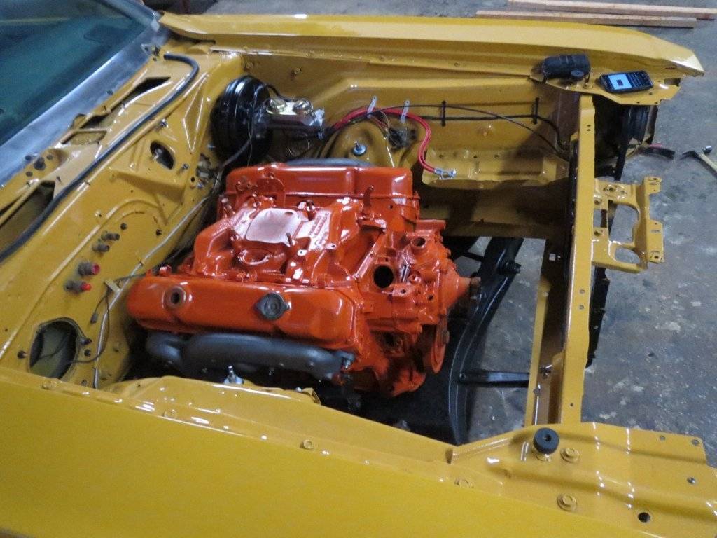

Got the engine and trans in yesterday!:usflag:
Car looks fantastic, very tasteful upgrades. I really like the rally dash, a new Tuff wheel would complete the look. (Just my 2 cents.) Keep up the great work.
