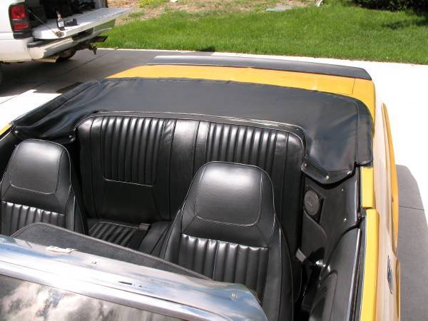

New seat covers installed, these are older pics obviously.

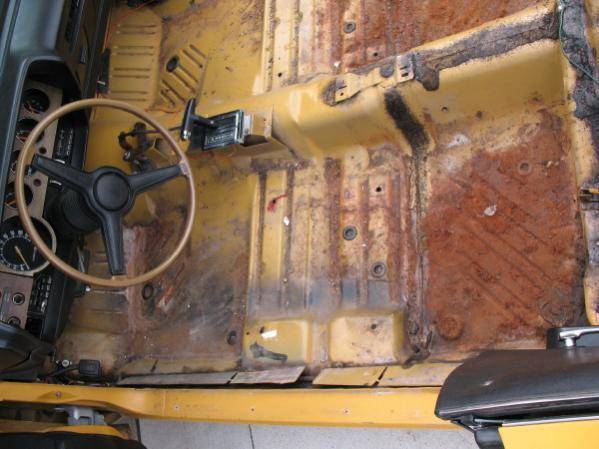

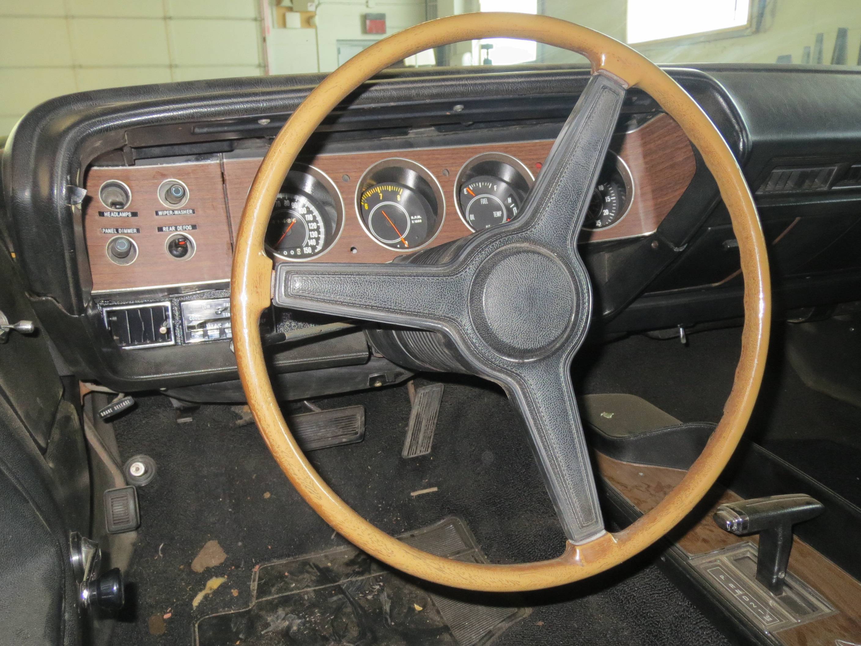

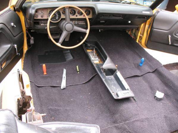

Here's the instrument cluster that was in it when my dad bought it. Not correct, the wood grain appliqué was a Baracuda Gran Coupe thing and a mismatched set of gauges. The new carpet going in and a shot of the floor pan. The rust in the rear foot wells was really just surface and I coated it with some por before the new carpet.
Damn so when did all of this take place? How long from when your buddy got it to this point? You're going to have it easily back together before the salt is off the roads.
