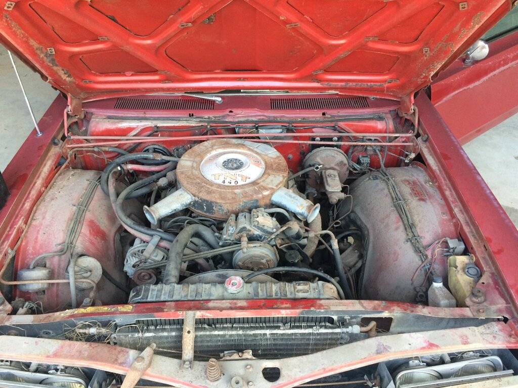

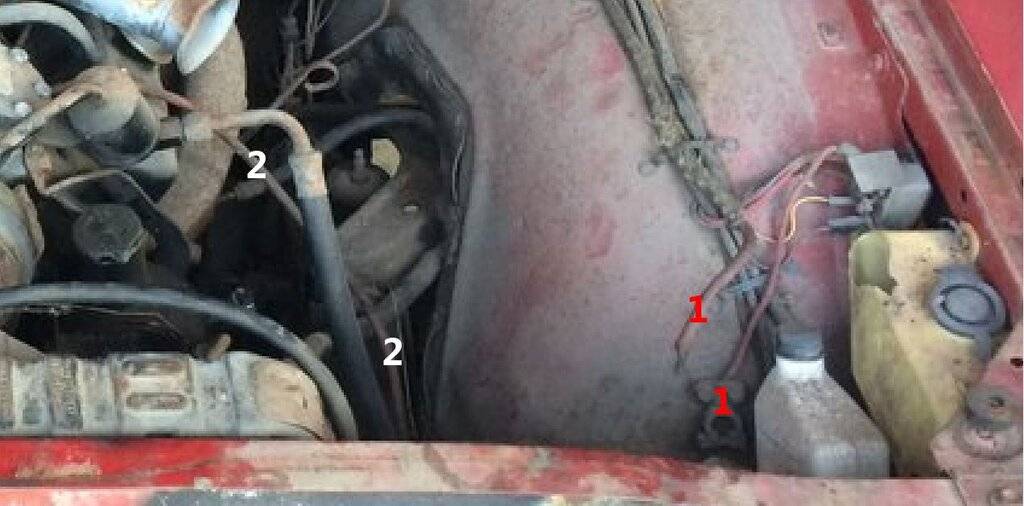

First I want to try to start it, which cable is positive, going to starter or little box.
I don't see a ground.

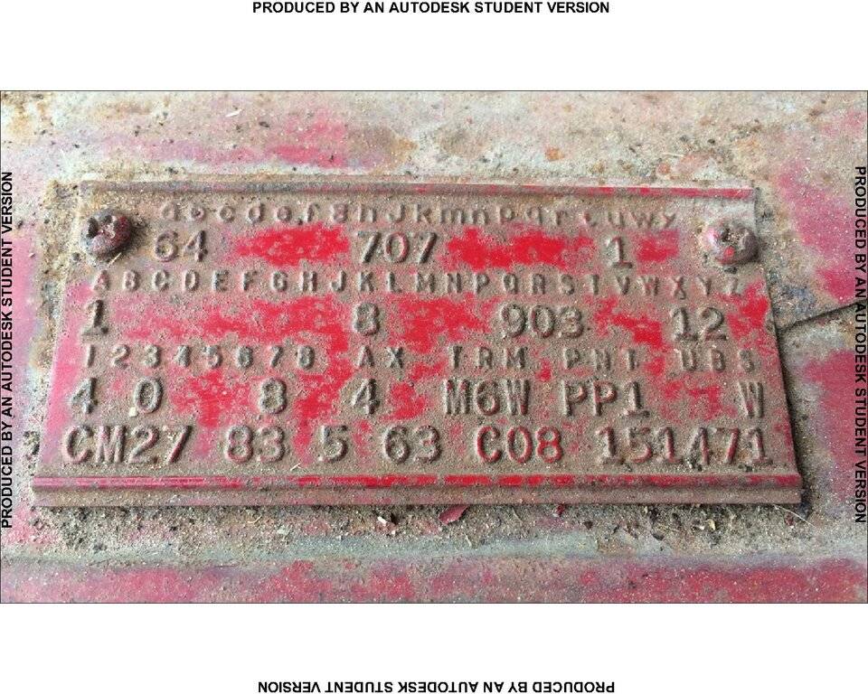

Some of the data plate option codes are hard to find, any easy place to find them listed.

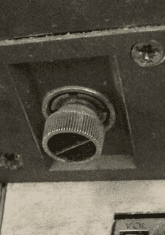

One last question for NOW, what does this little knob do.

Knob looks like an aftermarket piece but in the correct location for the rear speaker balance roller style knob.
how do you decode a 68 tag to see if its a TNT or not ? i havent learned pre 70 vins/tags except 64 imps.......
nice it has air, a TNT with air in a convert is rare
1 to 1 should be attached this is Battery positive.
#2 is most likely your ground and should go to a intake manifold bolt. If the cable is red in color it should be change to the correct black color cable designating the Negative so that no mix up of proper connection to the battery or when jump starting the car.

Bottom line on your fender tag CM27 which is a Chrysler 300 convertible, After that I believe the 83 denotes it as a TNT as mine is 81 and I have the base 350 HP 440. CO8 is your “build date”, which is December 8, 1967. Under PNT is your paint color , PP1 is scorch red. Under TRM, this is your trim, interior color M6W is which is White/black bucket seats. Your fender tag has lots of codes on it, a very nicely optioned car.

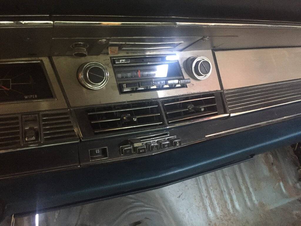

The knob actually matches the volume and tuner controls on my Multiplex AM/FM radio with 5 speakers. This was optional, so the thumb wheels would only be found on the standard setup
The fader knob is original. It replaced the earlier thumb wheel at least on the AM/FM and the AM/8 track. I would wager this is a later '68 with the black tail panel.
The later AM/FM had the round knobs vs the thumb rollers. I think they switched over mid year in '67.
The reverberator is a separate thumb toggle switch that turns on an additional unit separate from the radio and the switch matches the map and power antenna switch in my '68.

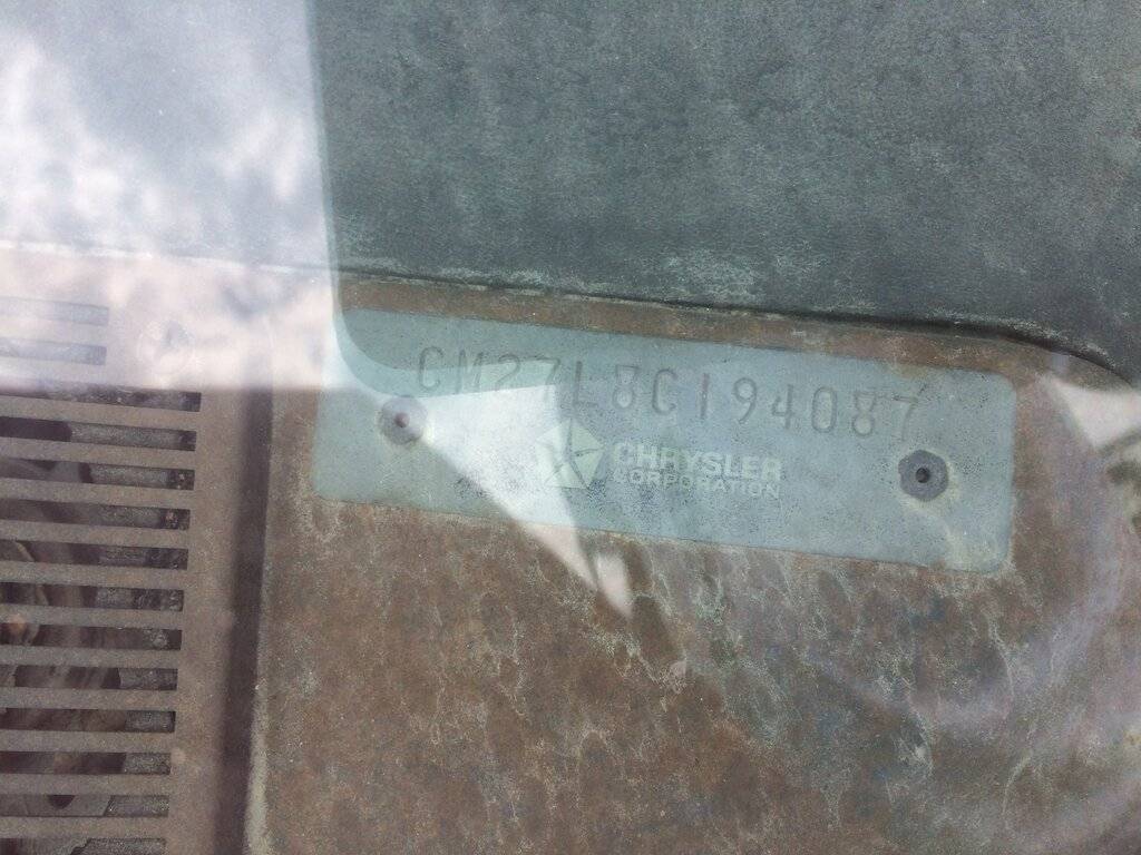

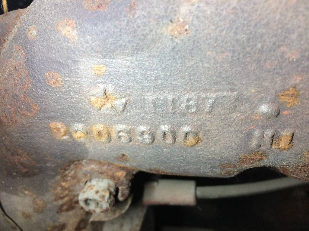

Also it looks to be a TNT beyond the air cleaner, as it has magnum exhaust manifolds. The 5th digit should be an L in the VIN. CM27L8...

1. First thing I would do is verify Engine. Run you Vin # thru a decoder such as " 440 Magnum Network " or other site. The 5th digit of the vin is engine. K is 440 4V , L is 440 HP / 375 , M is Special V8.
2. Run you Data Tag on Fender thru a Fender Tag Decoder. You can try MyMopar.com , Yearone www.drivinithome.com , or other site.
3.Red Cable is almost always Positive/+ . Picture shows it running to Starter Solenoid Relay on Fender. The ground wire is Black....Negative/- and normally runs to the engine block. My car is grounded on my AC compressor.

The knob may be for balance and the thumb wheel a fader. I expect this may have the additional speakers on the dash.
I tend to agree with you on the engine. My car has an #82 engine and its a 440 HP ,375 horse.

Yes the Vin starts with CM27L8.
I added a pic of the Vin and casting number for the exhaust manifold drivers side.
