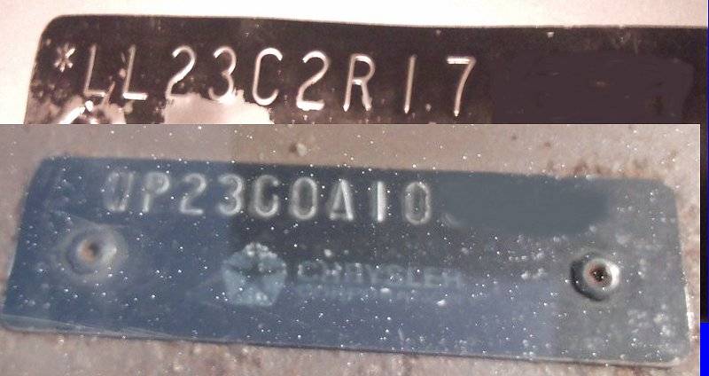

I remember reading somewhere on here about the rarity of a 67 Newport FAST TOP slant 6. Is my memory serving me correctly? Is this a rare car?
It is common for the tail of a "G" to not be properly stamped making it look like the letter is a C.
People often see this and interpret a G code 383 car as /6
Could that be what you saw?
Legitimate pre 1970 "C" VIN cars would be very rare.
Here's a comparison between a "C" and a "G" missing it's 'tail'. A "G" will come up higher on the right side of the letter.
Gut feel: the fender tag will show engine code 61.
its a definite possibility! I just did a quick search. I'll be driving by there to drop some bids off so I'll take a closer look and get some better pics anyway.
