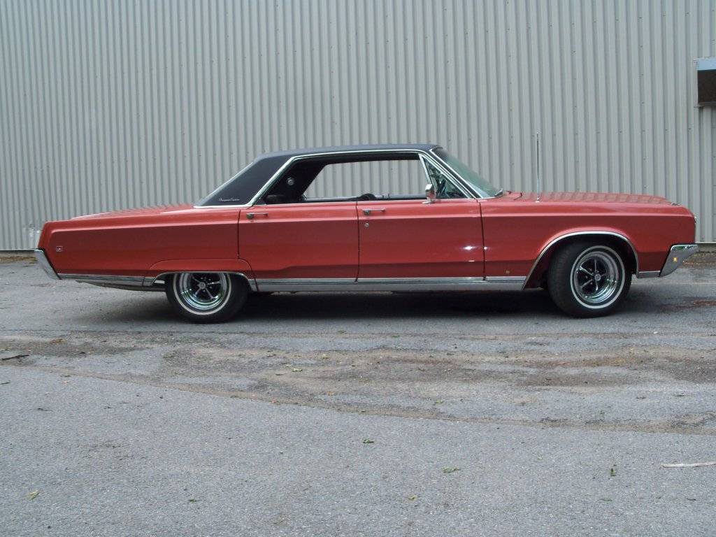

I run 23570R15 on Magnum 500's..Not "original" but looks period correct.
At 28.0 inches tall,bang on regarding O.E diameter.

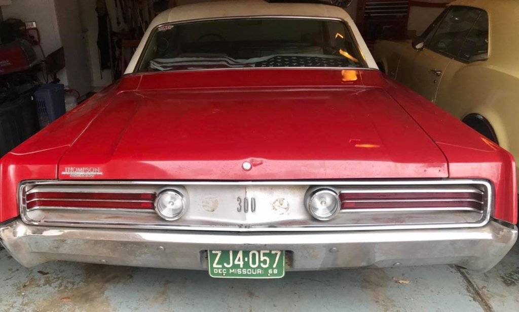

Greetings and questions... The "bezel" for the taillights is Silver on this car and looks like crap. Is it a hard job to pull it for painting? Or, should I leave it alone since I think it's OEM.
I am trying to stay rock stock but that thing is fugly.
Also, the other 300s I've seen on this site have a black bezel. Were there multiple color options for that piece?

Your bezel looks to have been argent silver as there is no indication of any flat black finish. The bezels were usually mounted with studs that stuck thru the butt panel into the trunk. You should find some trim attachment nuts on those studs that are removed to free the bezel panel.

There was a running change from argent to black (or vice versa?), can't remember my info source. Mopar & others sell argent paint for that. Sharp 300!

My Dad's '68 300 was bought in September of 1968, so I believe that was a later built car. It had a black tail light surround. I've seen the both even with the same body colors.
Of course, I could be completely wrong, as I don't think anyone, especially me, was thinking about build dates then.

My March built 300 has a black taillight panel.

Any possibility of cleaning it up? It's only original once..
