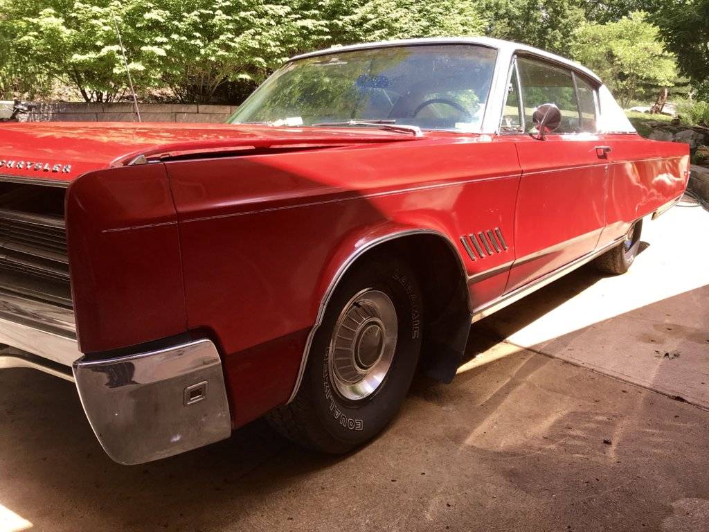

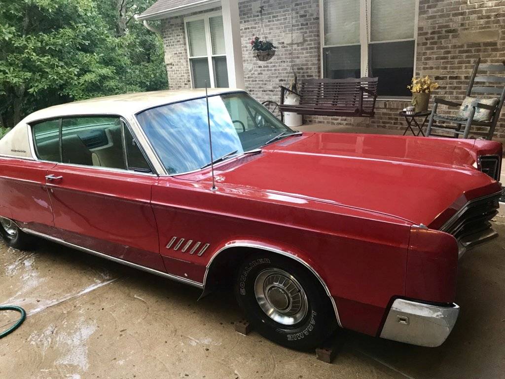

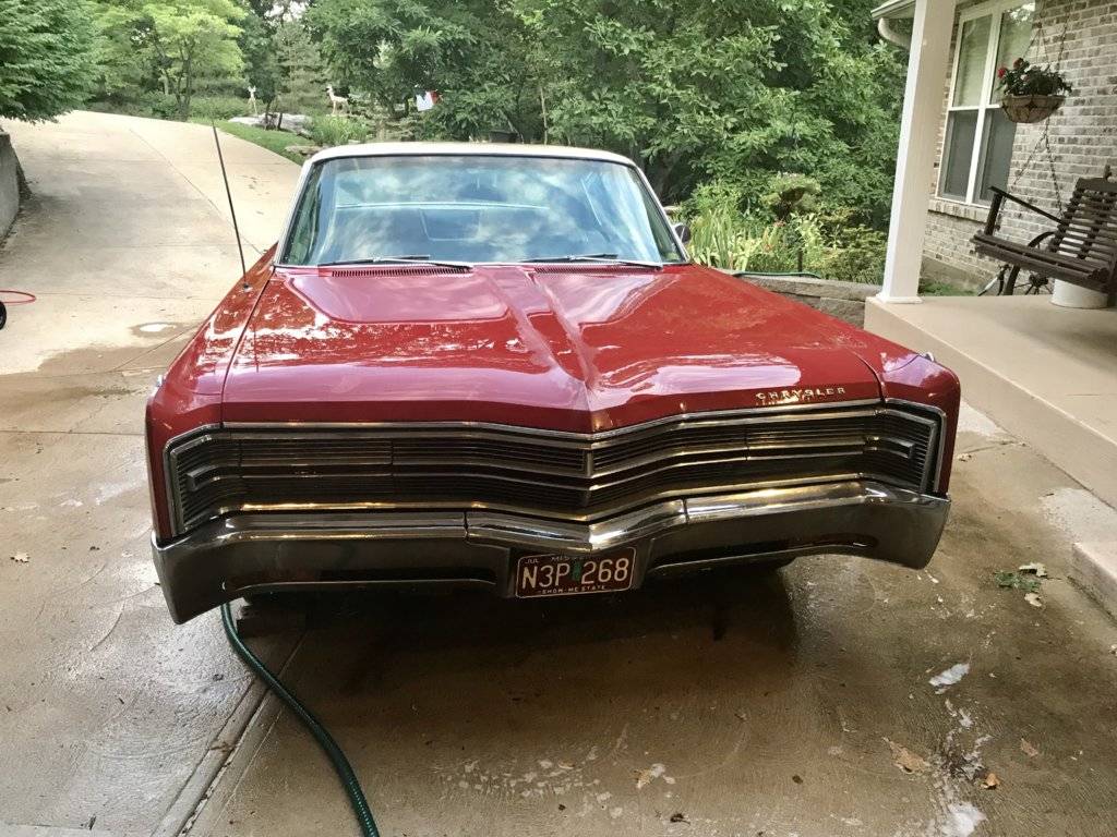

    I brought home Dad's '68 and gave it a bath tonight.
    License plate says '92 so that was the last time it was on the road.
    So far it looks like it is all here. No rust at all, at least none that I have found.
    He drove in the shed, parked it and pulled the battery. It's amazing to me how good of
    shape this beast is in. Should be a fun project to get her on the road again.

    Be sure to check the fuel tank before you try to start it, you do not want to suck up a bunch of degraded fuel rust etc. Brake system should have new components such as wheel cylinders, hoses and master cylinder before you try to drive it as they are likely in bad shape from sitting that long. Very nice looking car.

    HOSE!

    My favorite SLAB year AND color too.The butt end iz remonicent of the Turbine Car, just love it. I'd drop the tank and head to the radiator shop and have it flushed and presure tested and blow out, flush out the fuel line from the pump back with BRAKE CLEAN before you even try cranking it over with fresh gas in it. Ia that ah '68 Calli Black PlateI'm lookin' at on the front of that beauty? Jer

    On 2nd look no it isn't, Number-Letter sequince iz wrong but a fine ride regardless, Jer

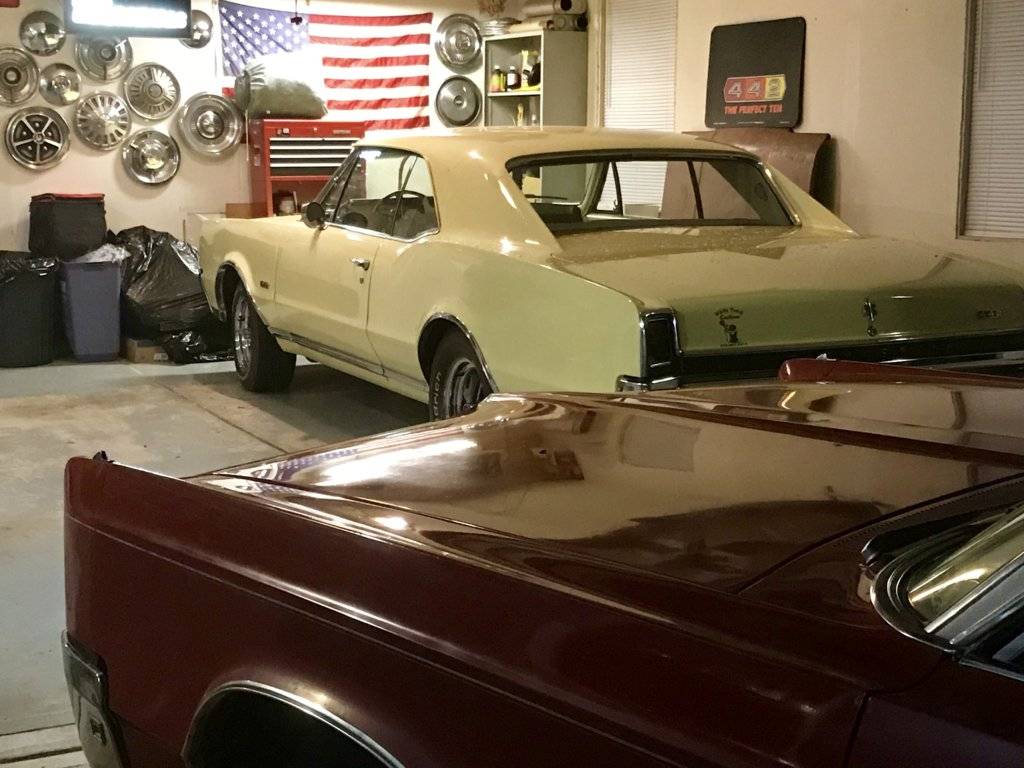

    A little car porn for everyone. That shine on the big red beast is real! I hit the hood with some compound and a buffing wheel to see what it would look like. That red paint is coming back nicely. I plan to do the rest of the car tomorrow.

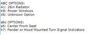

    Seems to be pretty basic. I am still sorting out the build. The online tool leaves a few things blank.

    Nice looking Olds in the background

    Gorgeous car! Side markers were standard on ‘68s.
    Post up a pic of the interior and the fender tag.
