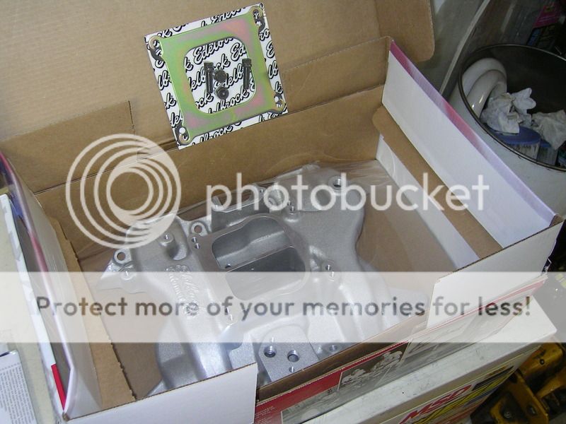

Ok so last weekend I swapped out the mid 70's cast spread bore intake for my new Eddy performer. Once the intake was off I saw a couple issue.
And now I understand why my oil always smelled so cooked!
New intake going on....
I swapped out the original big block 71 intake bolts for a set of mid 70's small block units. I like the small block bolts because they have a captured washer on them, so it will help protect the aluminum intake.
I had to tweak the throttle bracket to work with the slightly taller manifold runners, and runner profile. I had to drill the hole to attach to the intake bigger, and also bend the tang that rest against the runner. And I had to re-route the vacuum line from the intake to the booster, since it's on the other side of the motor now. Other then that it was a fairly painless job.

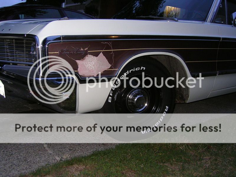

Yesterday my neighbour and I had a bunch of tires and rims swapped around. I needed new tires for the wagon...the 10 year old tires on the wagon were getting hard as hockey pucks, with no wet weather traction. He had a nice set of 225/70/15 BFG's on his 63 Impala, only about 2 years old and probably 1K miles. He had bought two bigger 245/70/15's for the rear and wanted a pair of 225/60/15's for the front. So I made a deal that I would buy the new front tires, and he would then give me the 4 old BFG's. Worked out well for everyone!
On our way to our tire guy. He's a retired car guy with his own tire machine and does this on the side (cheap) for car money. We had 11 tires and 9 rims that had to be swapped around.
And the tires back on.
I absolutely love it!
