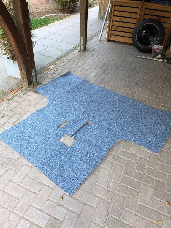

Thanks for the recommendations. Priming and painting is my job for tomorrow. I'll probably finish it off with some bedliner for the centre section.
I've looked for a replacement mat here in Germany but without success. So I've cut my own out of a piece of carpet. If I'm hearing you right it seems like the better option?
A carpet with a fabric backing, that is not plastic-coated, will not form a vapor barrier between the sheet metal area and its back. It'll "breathe" better, so to speak.
The roll-on bed liner coating would be a good move, too. Can help with sound deadening and panel stiffness, too, I suspect.
