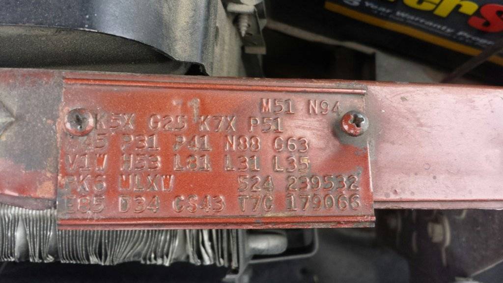

The seller just sent me a picture of the Data plate: give it to me straight Johnny!! Could one of you fine gentlemen give me a breakdown please??
M51 Sunroof, Electric
N94 ESA W/Cat/con 75/up
K5X Body Side Moldings W\Vinyl
G25 Vent Windows, Manual
K7X Body Side Stripe
P51 Power Steering
M45 Fender Skirts (in Fuselage)
P31 Power Windows
P41 Power Door Locks
N88 Automatic Speed Control
G63 Mirror, Remote Control Right
V1W Full Vinyl Top
H53 Air Conditioning W/Autotemp
L81 Door Ajar Indicator Lamp
L31 Fender Mounted Turn Signals
L35 Cornering Lights
PK6 - (Colour Code)
E85 440 4BBL
D34 TF Automatic Transmission
