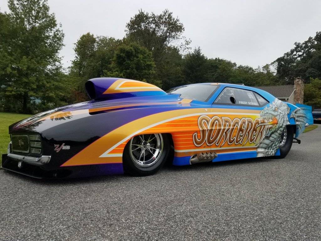

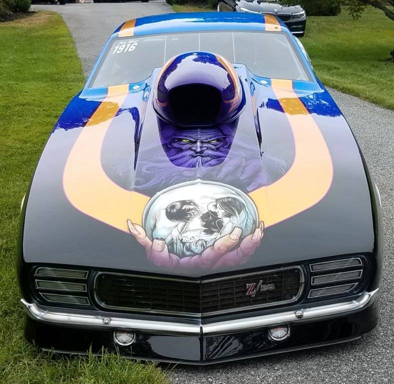

My friend's ProMod is a Pat Musi 959 cu in with 5 stages of nitrous. He shifts at 9200 rpms at ends up in 5.70's @ 253 mph.
