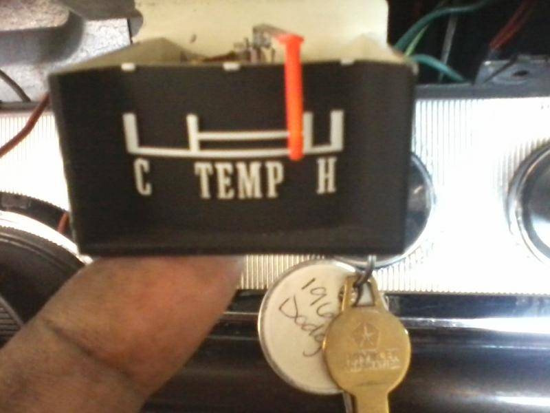

0329131420-00.jpgI replace the thermostat and im not pegged to hot anymore. That temperature is with the car sitting in the garage nose first just idling. I assume out on the road it will come down some. Does that look alittle too hot? When i turn the blower motor on it will drop to about the M on the gauge. Would a temp gun aimed at the block give me a good indication of the real temp in degrees?
Is the top radiator hose hot and rock hard after the engine warms up? Same with the bottom radiator hose? Does it have a fan clutch? If all that checks out it may be the temp sending unit. why is the temp gauge not mounted?
Sending unit is good, i replaced that and checked it in boiling water with gauge and batteries hooked up to it. 180 degrees is around the end of the E in temp. Hoses are not getting rock hard. when should the fan turn on and off? Should be on when at idle and off with higher rpms correct?
