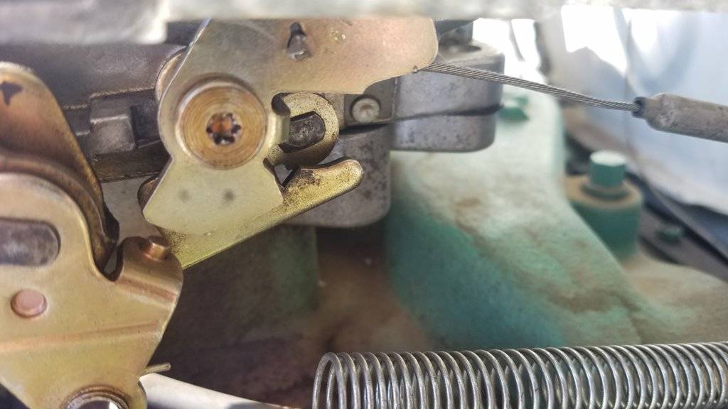

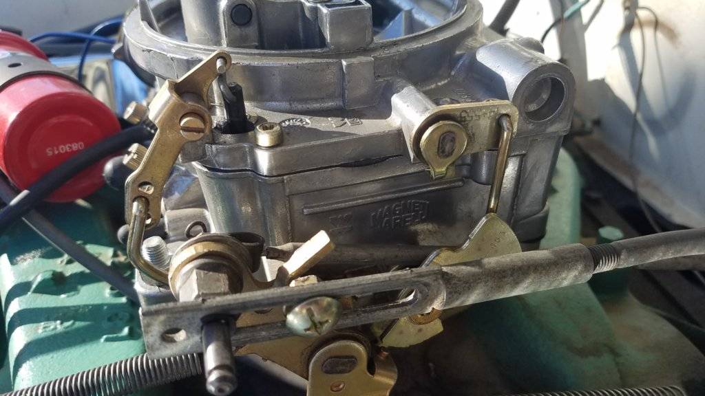

So I noticed this is the only piece that opens up the butterfly that allows air into the primaries I guess you could say. For some reason that is completely closed and will only open if I take my hand and push down on it there is absolutely nothing as far as the spring or adapter hook to it it just kind of all by itself. When I push on a throttle cable it does not open up.

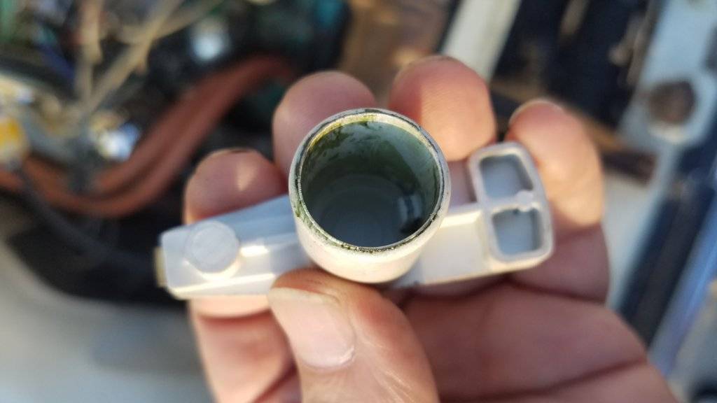

So I was also looking over my points... everything looked ok besides I ha e this green liquid inside rotor?
That should be your "fast idle cam" which is attached to your choke. It operates when the car is cold and the choke closes. You can see the adjusting screw just barely sticking up under the cam. The cam usually has a step or two that the adjusting screw will rest against. When you pump the gas twice just before starting the cold engine, the choke should close, and the fast idle cam will drop into position and ride on the adjusting screw. This will raise your idle up and your engine runs faster to speed up engine warming. As the choke is opened, ie when you snap the throttle to lower the fast idle because your engine has warmed up a bit or if you begin to accelerate to drive off, the fast idle cam will be moved into a position where the adjusting screw will not be against the fast idle cam - just like in your photo. You carb will now run of the idle adjustment screw found on the side of the carb. This screw is the one you set for normal warm engine running. So your carb has 2 idle adjustment screws, the one for your fast idle when cold, and the one for normal idle when the engine is warm.
If you open the throttle by hand just a small amount and hold it, you should be able to manually close your choke and you will see the choke rod activate the fast idle cam to which it operates.
