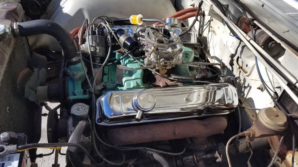

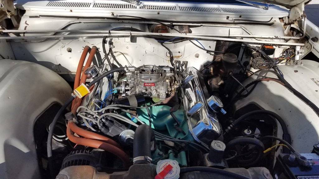

Oh forgot to add, pretty clean engine/bay ya got there, the pic ***** in me want's to see a complete shot of the engine bay. (so do others I'm sure)
