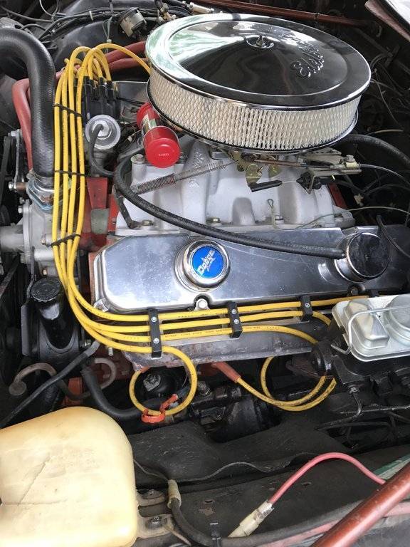

Hey C-bodiers! Anyone know a set of headers that will work with my '71 Newport w/angle plug heads? It is a 496 Stroker and isn't breathing well.It has stock exhaust manifolds. Would HP manifolds be as good as headers? Does anyone have anything for sale?
It's puzzling. I bought the car with this monster motor, race trans, and 4:10s. Stock manifolds, 2.5inch exhaust through generic muffler shop mufflers and Honda Civic boy racer tips. I'm not trying to be Don Garlits, but I would like this thing to breathe a little.

What kind of heads?
Can't see how that many cubes couldn't be suffocated by log manifolds, unless the heads were the choke point.
Lets say heads breath enough and intake also. My estimate is that those logs lose like 60-90hp and 40-70 torque.
800cfm not enough, it depends of heads, intake, cam... etc.
I thought you would have had to use center dump manifolds.
How the hell are the wires on angled plug heads not smashed against the manifold on 5&7/6&8?
