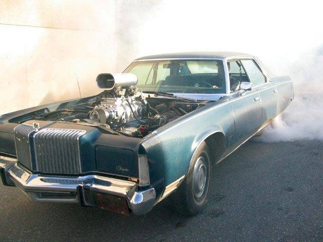

That sounds to me exactly like:
Landau vinyl roof on my 2017 Hellcat.
Same thing...
The difference is I will only offend your sensibilities if the hood is popped. Your Landau Hellcat offends everybody with sense, like 24 inch wheels on a NYB ( or 99% of the donks they put them on)
