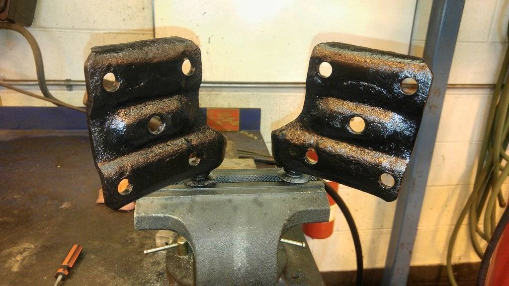

Has anyone ever done the Isolator delete on a C body? Did it make a difference in handling and performance of the springs/shocks?
I'm seriously considering it for my '73.
Nick
69 shock plates

I forgot that the springs I'm putting in the car came off the '73 Newport Tom had.
I looked at my springs that came out when I got home and sure enough, no ISO plates....apparently I made myself a pile of work for nothing.
The convertible is going to get a PST rear swaybar kit I think.
