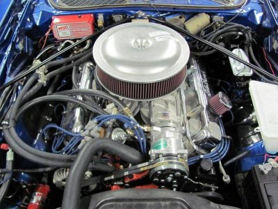

Here's one set of my Stealth heads that I sold and used on a 440 that I built for a friend...
Isn't that the World Products head that's the copy? I thought 440 Source built their own. They're made in China, to be sure, but I think the copies are a different company.
Nope, they are an Edelbrock copy, as are the Mopar heads, except Mopar went through the process properly (not like an *** Bandit) and they do their own casting (Mopar cast in "M") with what I have found personally with the LA heads to have better quality control.
