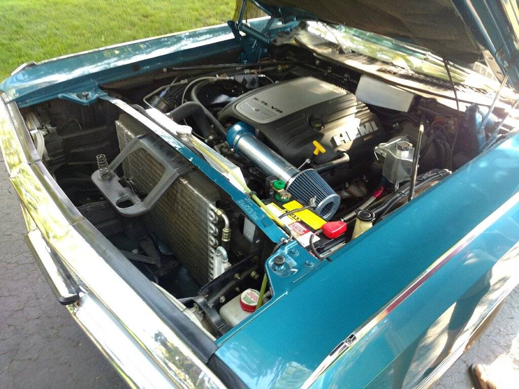

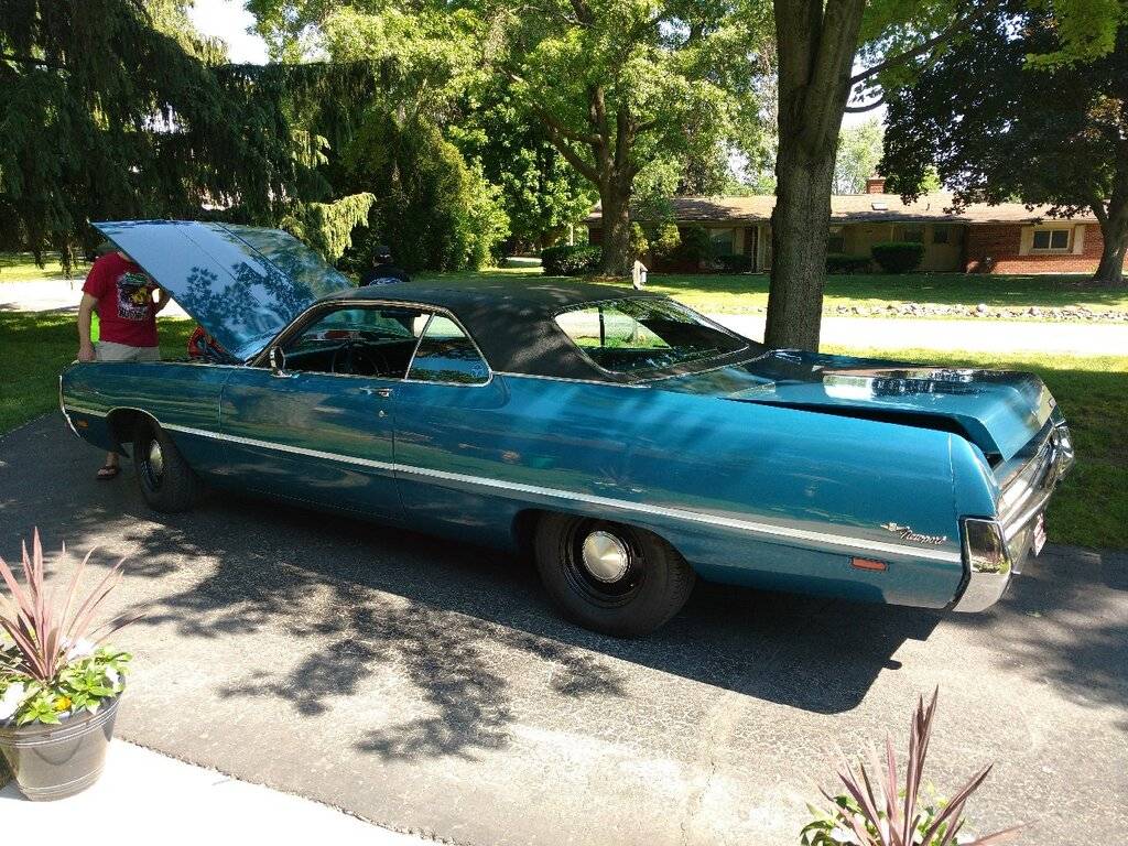

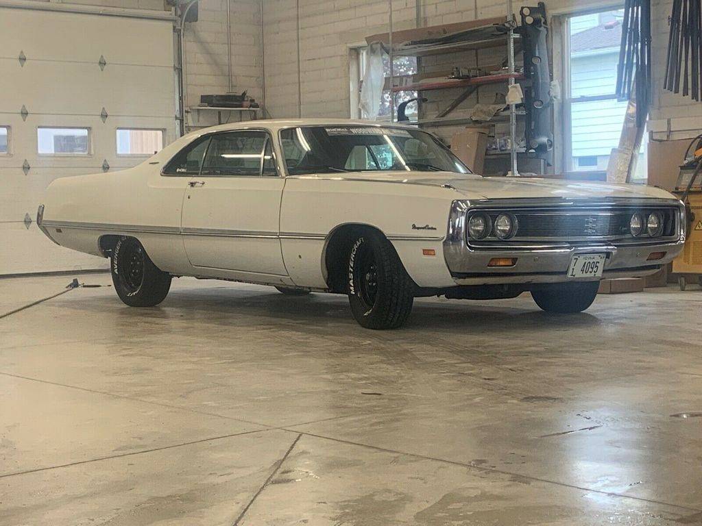

At my buddies cars & coffee yesterday. Well I should say it’s all completely original except the engine, trans and the paint on the hood...ok and the cop wheels. This beauty is in amazing condition but I will say I would much rather see the original 383 2 bbl in the engine room. The owner has had it for 20 years and I think it has 40k miles on it.
Beautiful car indeed. The engine bay looks a little...different ;)
I agree with you that 383-2 would be better, but I gues it brings a lot of fun at the traffic light :steering:
This wonderful car deserves the original engine. I hope he atleast kept it and the next owner can put it back in.
The car looks absolutely amazing! AND, it's "all in the family". NO possibilities of "tissue rejection". VERY well done, although I might like a different wheel/tire choice. Very good, as is, though.

Nicely done and beautiful car. If there was a decent tutorial and parts list, it would make a lot of these rollers come alive again.
Seems like there are some threads in here about putting the 6 or 8-speedd automatics behind B/RB engines? Plus some builds on making the GenIII Hemis fit in the earlier cars, to? But possibly not a comprehensive parts/source list? I PM'd with the member that did the '67 or '68 Fury III "23" a while back. Seemed quite easy! Used the Gen III radiator, too, as a "bolt-in" situation. Just needing a place to put the radiator cap, but it appears the particular Newport used a normal radiator and hose?
Granted, the newer engines make good power, but it's the later automatics that make those engines work as well as they do. That 4.50+ low gear ratio makes up for a lot of "launch" performance that was previously done with low-end, off-idle torque of the larger displacement engines. The engines being lighter weight makes up for that heavier transmission, too. Wondering how the driveshaft interface works?
How to make the electronics for the engine work? Some I've talked to seem to think that putting a carb and distributor on them (as Mopar Perf had items to do, in the first years?) makes no sense to them, but MIGHT be an option if the Gen III engines become more plentiful from the salvage vendors? Similar with the Chevy LS. These things won't make the cars more valuable, BUT might make then more saleable to younger enthusiasts who know what they're looking at when they see them AND know how to work on them.

I neglected to find out what he used for a transmission, my bad but these swaps don’t normally make me want to know too much more about them. He was a very nice old guy who I’m sure I’ll see again And I’ll find out more. What I do know is that he said the original driveshaft required no mods and that the whole thing was basically plug and play. I was blown away by the rest of the car.
Well I phoned a friend and found out he used the original 727.
The swap is pretty straight forward if you're not using the 5/8spd trans. Get a 2005 ram computer and a hotwire harness. I agree a lot of the advantage is in the trans.

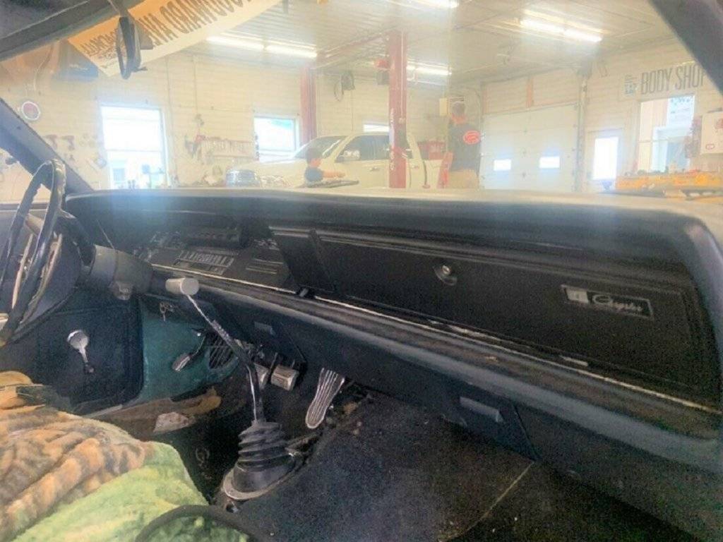

The biggest drawback was it looked like you would have to sit in the back seat to shift.
I have the perfect candidate for this type of project it's a 68 sport Fury Factory 4spd car but does not have any running gear in it ((LONG GONE)) was thinking about a 440 4spd for it but this combination might be just the ticket
You should be able to convert the manual trans to mid shift.
