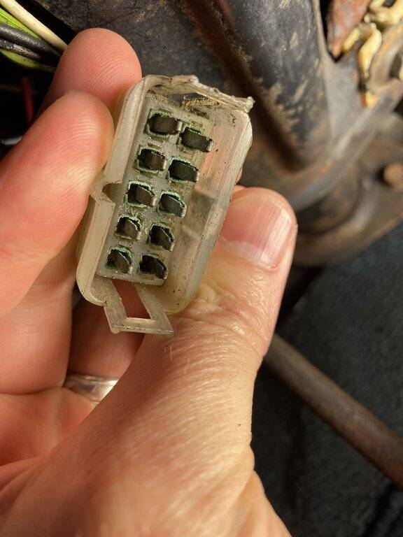

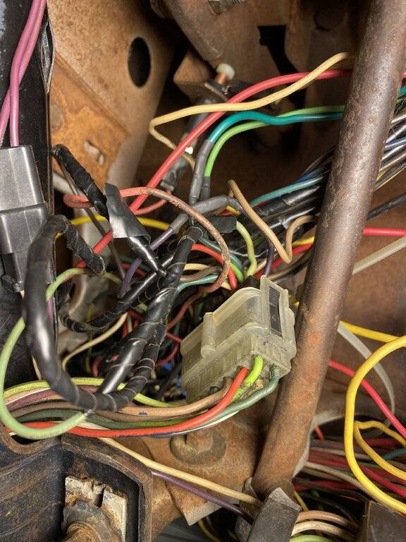

I am having similar, non consistent issue with the back end lights. I am honing in on the issue. I do think it is ultimately going to Reside in the turn signal switch. I have a new switch from She-mar (I have a tilt/telescope column), but I am going to start by reconditioning the existing connector down at the base of the column. Seems like if I give that connector a good wiggle, the rear lights come back to life…
my main issue is intermittent driver side break and blinker go out. My latest wiggle actually brought the dash blinker indicator back to life! I thought those died year ago.
my main issue is intermittent driver side break and blinker go out. My latest wiggle actually brought the dash blinker indicator back to life! I thought those ideas year ago.
I hope FOR YOUR SAKE THAT YOU HAVEN'T OPENED THAT SHE-MAR SWITCH until you've thoroughly EXHAUSTED EVERY OTHER CONTINGENCY. It may well be a connector issue, especially if the old connector has been oxidized, or the wires leading into have been stressed.
Can you make NEW connections which will interface the old connector RELIABLY? If so, do that, then see if your problem is solved. You might yet recuperate the price of the She-mar switch, though it gets harder every day of delay.
If you've unpacked the new switch, then try it and see if your problems vanish. They SHOULD, IFF the switch caused them! I suspect otherwise, though to be sure, worn out contacts in ONE part of a circuit will cause heat, oxidation and failure then in another...and another...ad nauseum,... ad infinitum, or at least until the harness goes Rice Crispies on you.
Now, have you tried hot-wiring each circuit lead from your steering column? THAT SHOULD light up the relevant lights downline from your connector. If NOT, then start tracing that bundle of wires back toward the trunk to the next unpluggable connectors; likely on the driver side, just behind the back seat in the forward area of the trunk, below the left speaker assembly or cutout.
Use a continuity tester from the switch to this connector, one conductor at a time. A test light here serves well.
Bring your hotwire back, and test each conductor to the rear lights at this point too. Any malfunction from this point is in the trunk wiring itself. Grounding issues become HEAVILY PROBABLE.

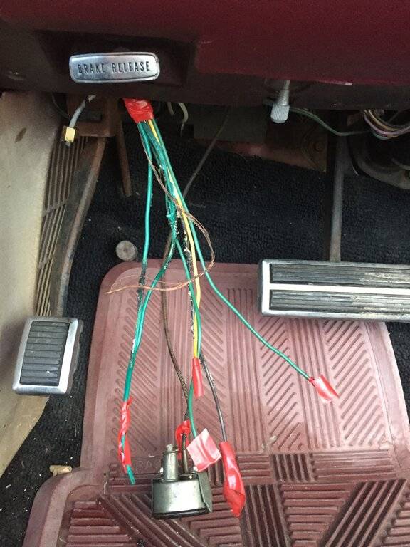

I got done responding and then opened your other thread...
Got some fried wires and I'll bet some of it is tied into the circuits you are having trouble with.

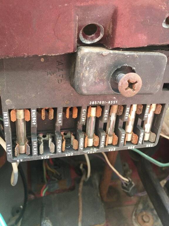

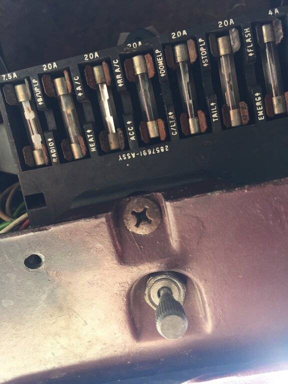

Pulled the kick panel off. No fuse block behind it. But there was a plastic bag and a pink tank top stuffed over the vent ...
Looked up and the fuse block is mounted under the dash.
It’s pretty corroded. Two fuses were burned out (one was a 10amp where it was supposed to be a 20). The taillights were not one of the two.
Got a qtip and some vinegar and tried cleaning the terminals.
Looks like rust, though ....
Perhaps a dremel and wire wheel(?).
Used a test light and it lit up on one side of the brake light fuse. Not on the other.

That fuse box will come out (big screw), and each of the clips that hold the fuses in place can be removed from the fuse box for easier cleaning. There should be a semi-transparent plastic cover that goes over the other side of the fuse box to help water not get into it, but it's often removed.
Make note of which wires go where on the back so you can return them to their correct places. Rust will make a difference in connections, as you already know.

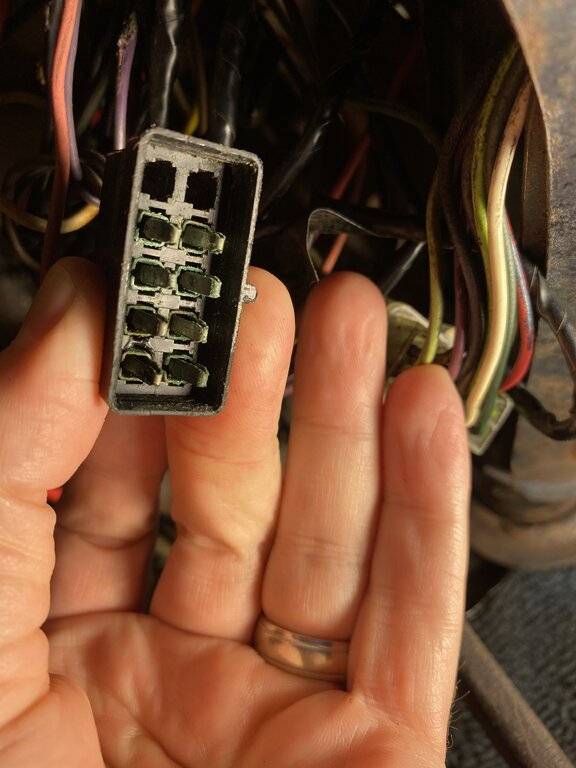

I feel like I had success today, I do think the source of my issues were in the connector. There was quite a bit of corrosion in there, but some electrical cleaner and a wire brush got it ‘clean enough’. But I think the real problem was the wire pins were loose inside the connector. It looked like a couple of the wires would push out the back a little when I would put the connector back together. I spent some time bending the little side tabs a bit and it seemed to tighten things up a bit. Pushed it back together and everything lights up great! Fingers crossed it is a lasting fix.
