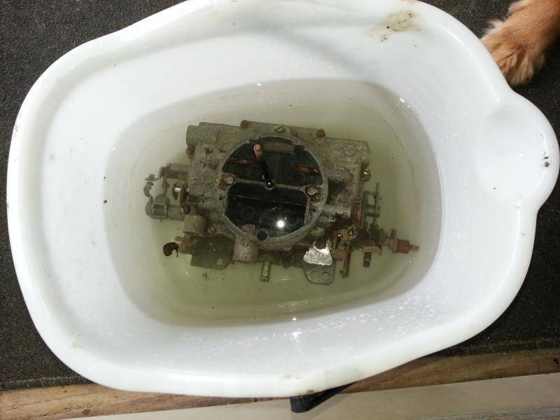

revisit Carb issue
I didn't know there were two kinds either. I'll have to add that note to my recipe.
I really think the lemon juice is needed though from what I read but I'm no chemist or metalurgist.

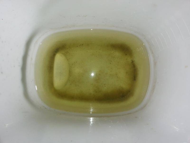

Pouring out the old stuff...nasty.
New stuff in and completely covered.

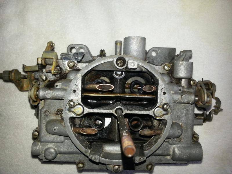

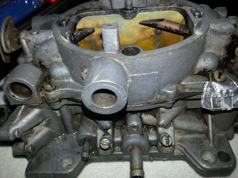

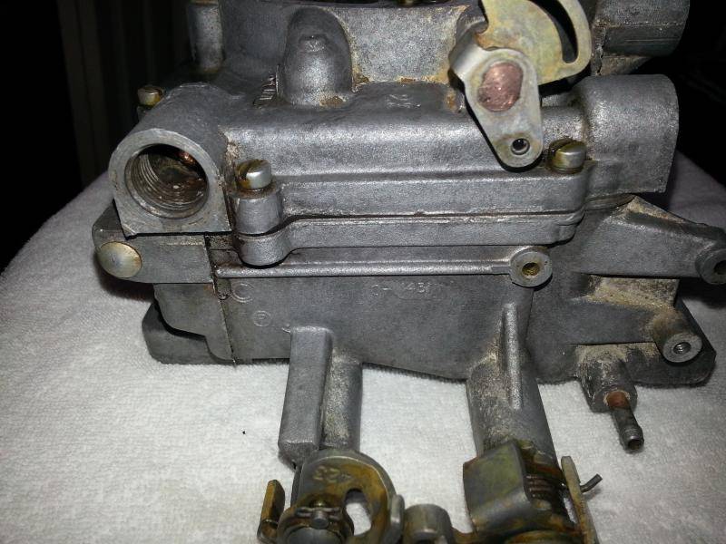

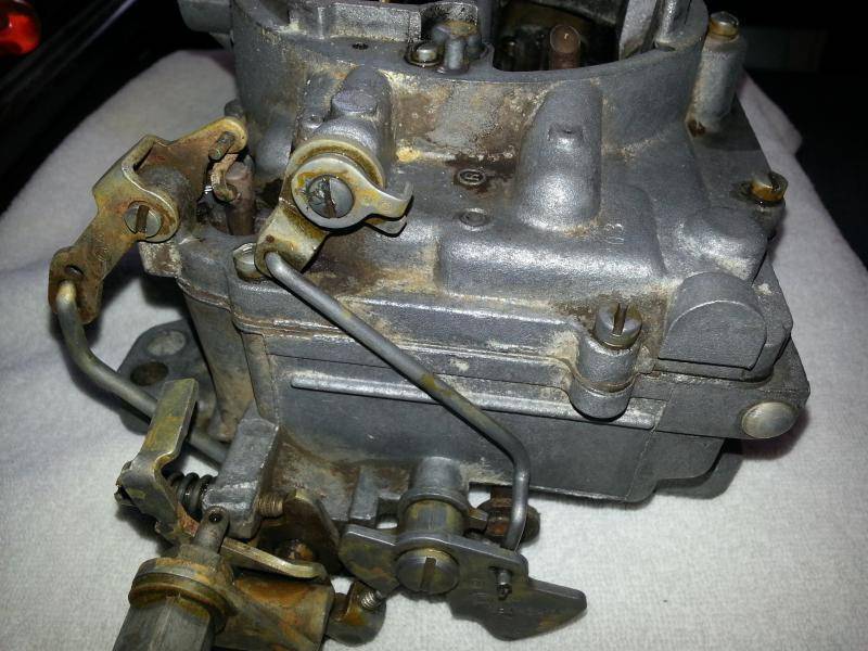

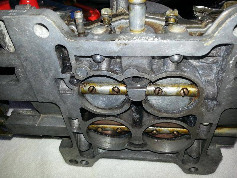

Looks like it does. Two gallons of 9% vinegar (not the 5%) and 16 oz of lemon juice. Soaked for 3 days. Used one of those green scrubbing pads.
