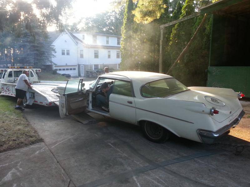

I bought this 60 Imperial Crown last fall, had been sitting since 1987. I got it home and the carb was corroded shut, couldnt push the gas pedal or use your hand. It looked like a science experiment with all the globs of corrosion growing all over the place. I took some wire wheel acid and sprayed down the entire carb..... let it sit for a few mins then rinsed it off with water.... I drove the car onto the rack and went thru the brakes and was driving it places in under a week. It freed up and runs beautiful. You may or may not have the same outcome.
