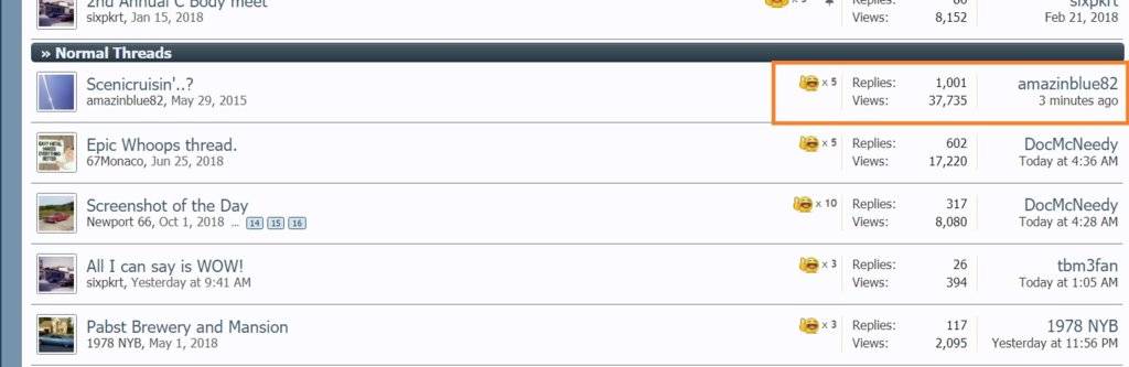

fun diversion. 1,001 Scencruisers were built. Although Jeff actually made post #1,001, it looks like I did it :)
Anyway, marking this "one-time-only" event in the life of this thread with this screenc apture.

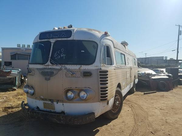

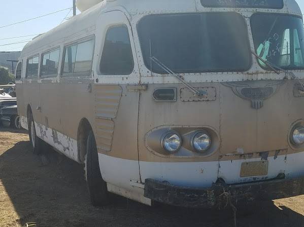

Here's another cool old bus.
favorite this post ***RARE , RARE, RARE 1950 FLXIBLE MOTOR HOME** - $3850 (CENTRAL PHX) hide this posting
image 1 of 10
© craigslist - Map data © OpenStreetMap
(google map)
1950 FLXIBLE
condition: good
cylinders: other
drive: rwd
fuel: gas
size / dimensions: 33 FT
transmission: manual
THIS IS AN OPPORTUNITY TO OWN A VERY RARE AND; COLLECTIBLE FACTORY RECREATIONAL MOTOR COACH, ALL ORIGINAL ***$5500 obo *****IT NEEDS AN ENGINE and TLC TO MAKE IT ROADWORTHY****CLEAN ARIZONA TITLE***A GREAT SWAP MEET VEHICLE OR GO WITH MODERN DRIVE TRAIN**GOOGLE FLXIBLE MOTOR COACH AND SEE THE VERY INTERESTING HISTORY OF THE COMPANY***I HAVE THE TWO BACK BODY PANELS****DELIVERY POSSIBLE FOR A FEE******
