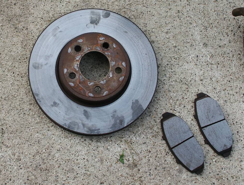

Might think about a few tack welds to eliminate any possibility of the stand sliding on the very hard and very smooth rotor. :D
The center "hat" of the rotor won't let it. The four legs of the stand nicely fit over the center.
A larger jack stand might possibly be able to slide a leg off, but I kind of doubt it. I haven't tired it yet. Most of my driveway mechanic tomfoolery doesn't involve jacking it up too high, so the smaller stands are perfect.
I just pointed it out in case you hadn't thought of it first. Good idea btw!

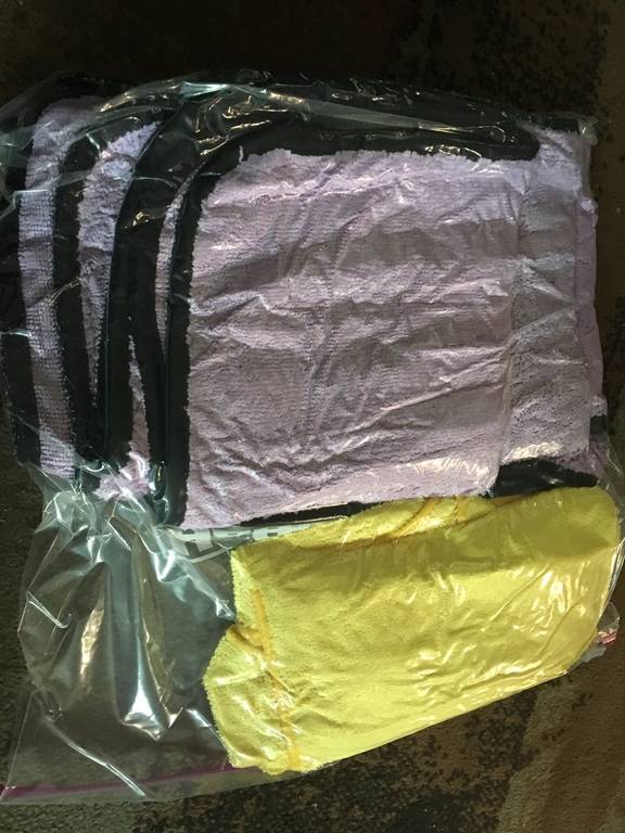

I carry some detail spray and microfiber towels to do a quick clean up (bird crap etc.) at a cruise night or show as needed. To keep the towels clean, I use a large zip lock bag. I take it one step farther and roll the bag up with the zip lock open a little and squeeze the air out. This keeps the towels clean and they take up less room. I also use the sample size 2 1/2 oz bottles of detail spray that Adams gives out in the Carlisle goody bag, (although they are filled with a different brand now). That's enough to do the complete car at least twice. You also can get spray bottles for traveling at Wallyworld and fill with your favorite detail spray.

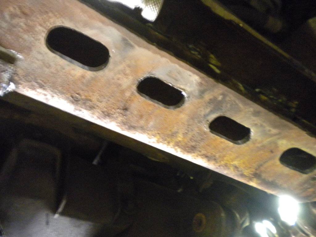

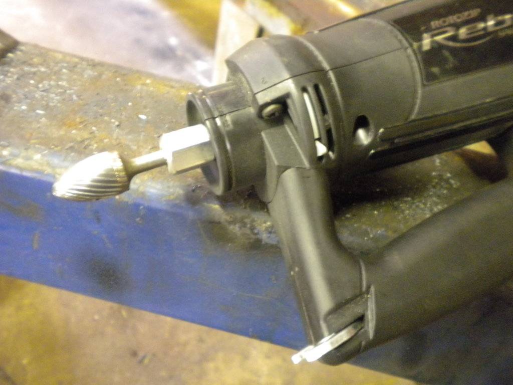

my compressor isn't big enough to keep up with extended use of a die grinder. had to do some metal work and didn't want to grenade the compressor so i put a quarter inch collet in my roto zip and chucked the largest bit i have. works very well.

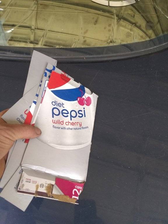

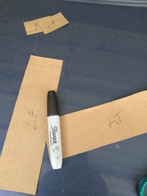

Most of us have heard about using cardboard to make a template when making a patch panel or small part.
This tip is about where to get free thin cardboard. Most of us have either a 12 pack box from pop or a 24 pack box from your favorite beverage. The cardboard is thin, cuts nice and best of all is it's free.
I burn so many of these, my wife loves diet Pepsi. I was making some templates for some patches for the trailer
