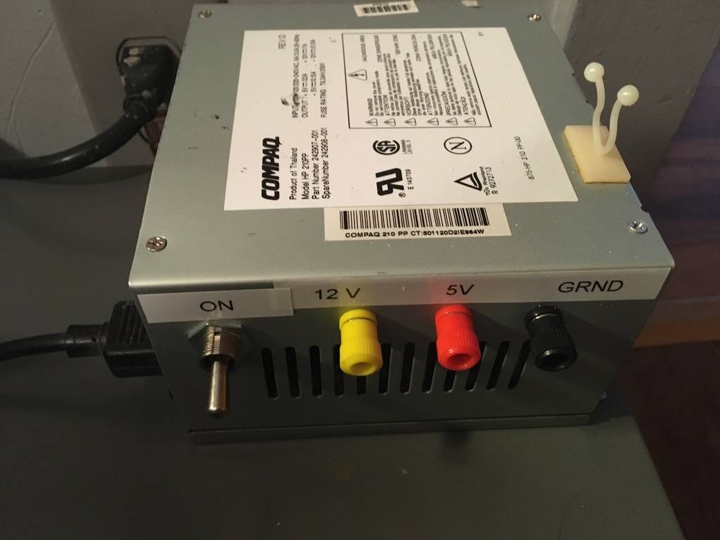

How about dirt cheap bench top DC power supply? This is mine, made from an old computer power supply. It has 5 volts, good for checking your dash gauges that run on 5 volts and 12 volts for everything else. The newer ones will have 3.3 volts too, but mine is pretty old.
There's a bunch of videos and online sources that will tell you how to make them. Here's one that looks like what I did. I didn't include the LED light though.
DIY Bench Power Supply With Old Computer SMPS
Been doing this for years. Good cheap P/S for sure.

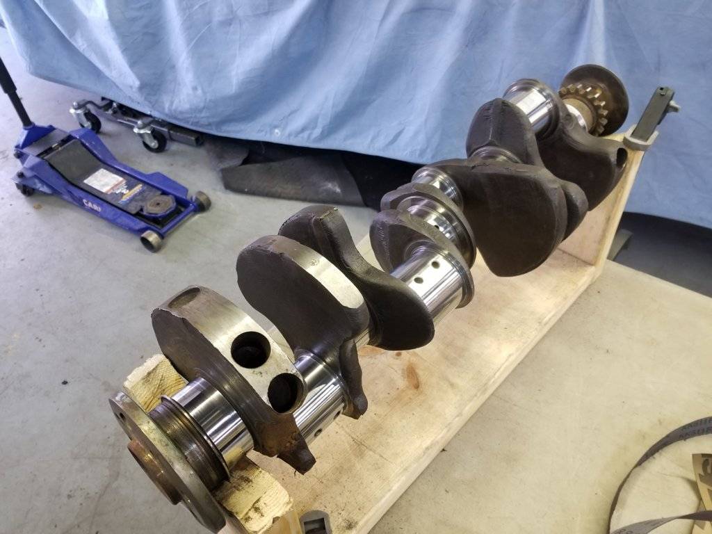

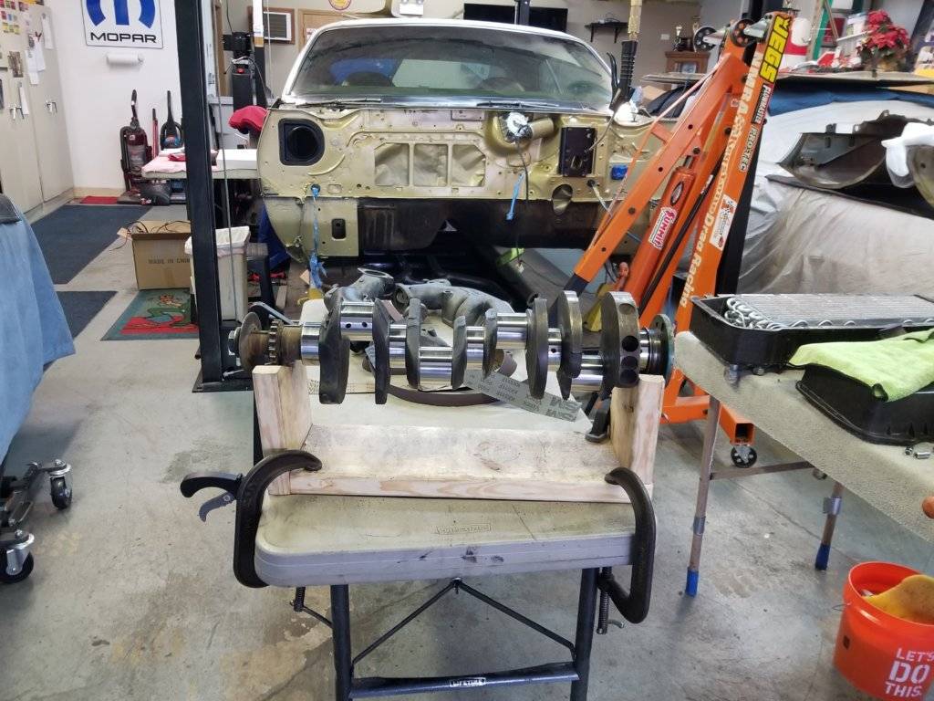

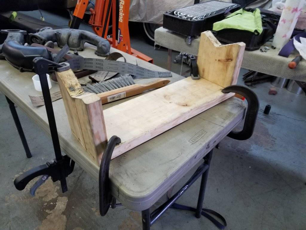

The credit for this crank stand goes to @Xenon. A piece of 2 x8 lumber, a saw and 8 3" wood screws.
I used it for the second time today cleaning this one up with 320/400 & 600 emery cloth. It's not even my crank.:rolleyes:

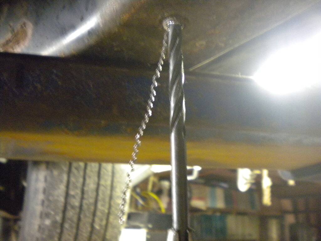

I've never seen that type of press. I did have to pull a 327C from a '73 Mach I one time and drill a snapped off mounting bolt from the drivers side of the block while it waz hanging in the Cherry Picker tho'. WAY NOT FUN, but I got it out without messing up the threads, Jer

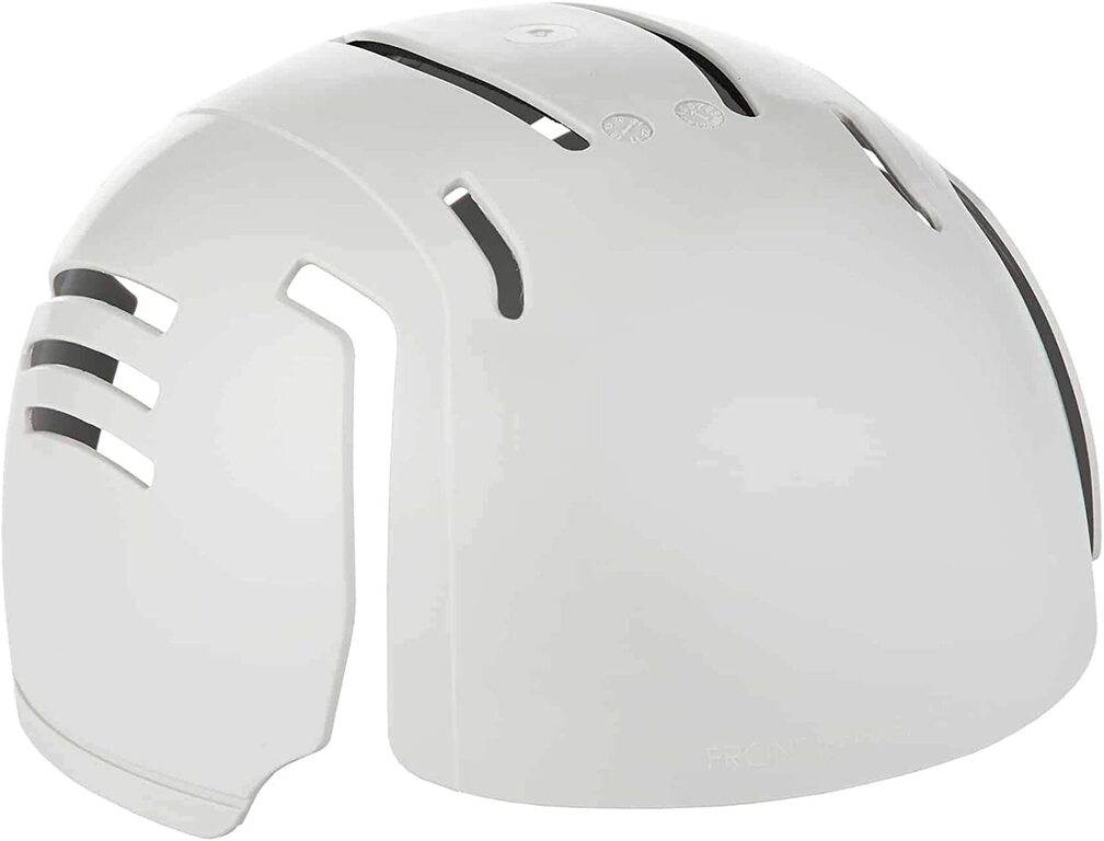

Since I bang my head a lot, and still seem to not knock any sense in it, I realized that I was gonna crack my head on my lift...
So I bought one of these. https://smile.amazon.com/gp/product/B079KDWN62/ref=ppx_yo_dt_b_search_asin_title?ie=UTF8&psc=1
I was going to just buy a bump cap, but these fit into a ball cap really nice. So far, it's working out well. I wouldn't say it would save you if the car fell on you, but for just the simple "didn't duck far enough", it's great.

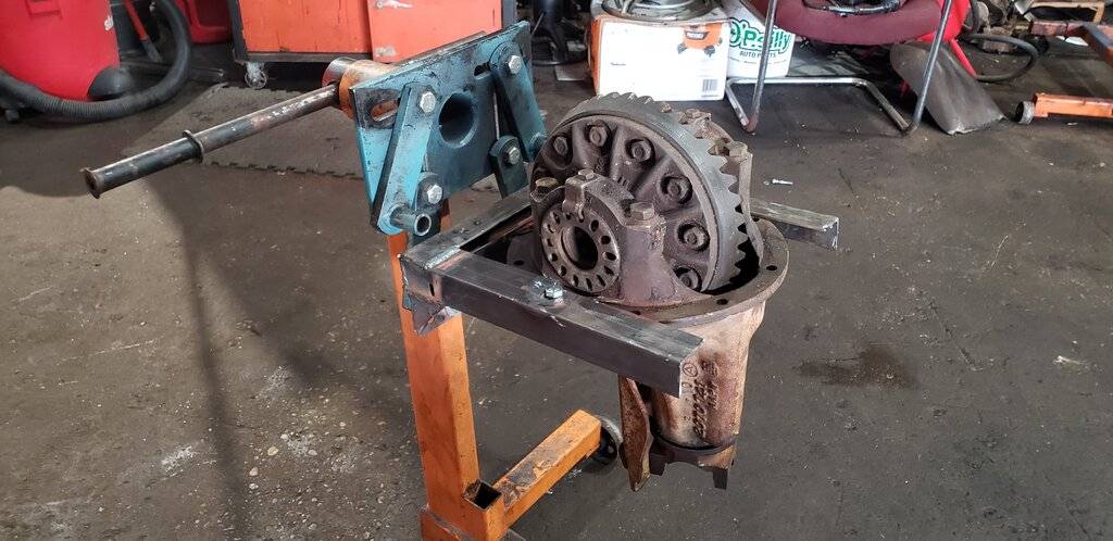

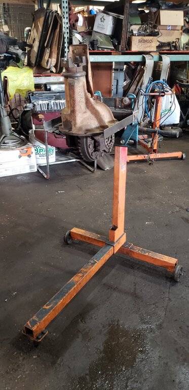

Fabbed this up with some old bed frame.
Should make setting up center chunks a breeze, and should last for a long time too!

Being 6'2", I've smashed my head into so many low beams in cellars and attics... The lift is a little different that it's steel and it freaking hurts to hit. The bump cap paid for itself just the other day... I walked into one of the beams so hard that it hurt my neck. My head was fine... My neck, with it's bad discs, arthritis etc. took a couple days to stop hurting.
