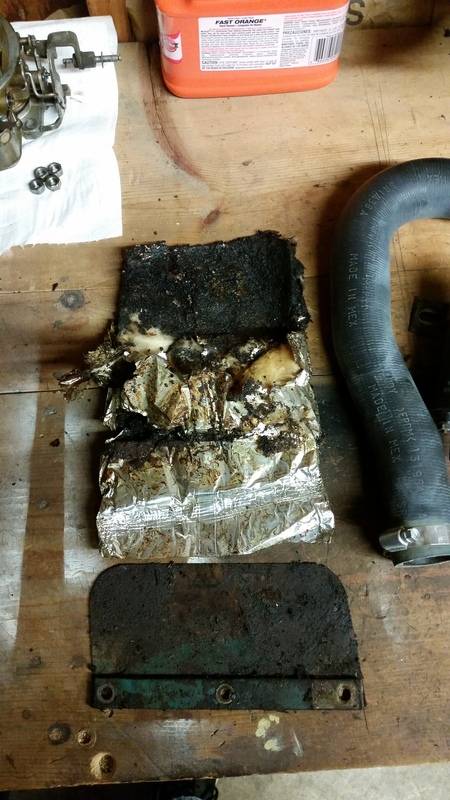

This was on the valley pan. Must have been something to help minimize heat transfer?
and this whole time I thought it was to keep my burrito warm! :rolleyes:

The purpose of the tinfoil wrapped insulation was to act as an engine noise suppressant, it does look ugly. I'm sure you'll file it in the appropriate recycle bin.
Well you can learn something every day I guess, the pad is used for noise AND heat related problems, thanks max1196! . I've always been told it was for the heat transfer issues, I stand corrected

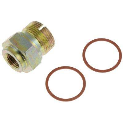

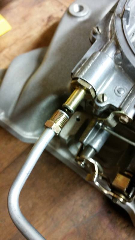

So what's the name of the thingy to make this connect to that?
That fitting is designed for a rubber fuel line with a clamp. I am not sure if you remove that fitting if the NPT fuel line fits but I would try it
You need a 5/16ths carburetor fuel line inlet connector specufic to the carburetor's manufacturer.
NPT fuel line
It's not NPT. It's a 5/16x1/2-20 tube fitting.
I'm pretty sure the same fuel inlet fitting is on every carter carb they ever made what kind of 2 bbl did you have?
This is a 1406 in the pic, which is replacing the Stromberg. Both the old fuel line and the new one in the pic have the same size fitting on the end. I'm guessing I'll unscrew the hose fitting on the carb and use what Commando showed.
Yes, if you had a old carter sitting around you could steal it from there. Went back and looked at 2 bbl it looks like it may be the larger fitting, it may fit, free to try.
