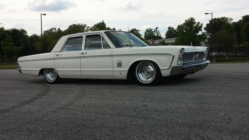

Good luck. You definitely should have a factory manual for your year handy. It will help tremendously.Oh, how about some pics....advice is not free.lol
Ok I'll pay up.
