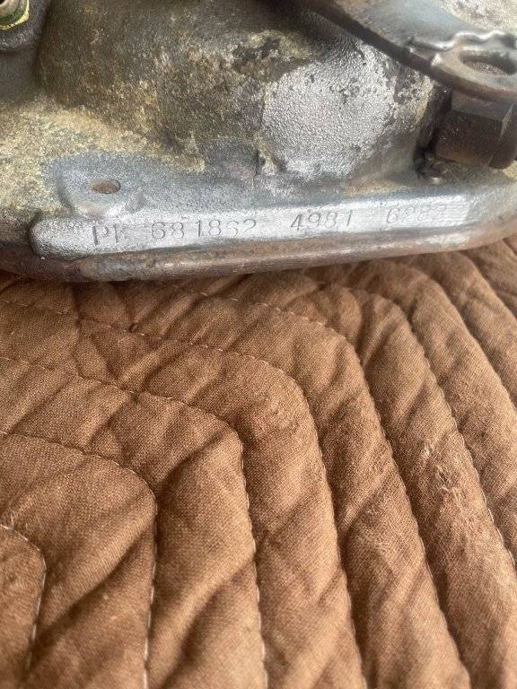

I bought a small block A727 I think I did not get a torque converter with it I wonder what size 10” or 11” converter stock I like to know the year of transmission any help would be great
Pk 68162 4981 6283 is number on side pictures you can not tell
Wire brush it, you are missing some digits. Need 7 digits after the PK
Date 4981 is approximately early 1975
Yep, need more digits.

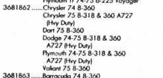

So, if there's any chance (if) we can assume that the PK number is 3681862, then you have a standard duty 727 which was mated to a 318 or 360 in a passenger car. Not heavy duty, and not installed in a truck.... that unit was used in both '74 and '75 which makes member 413's post quite valid.
Actually I find info calling both heavy duty and standard, but there's not a world of difference between them.. Also, NOT a lockup trans.

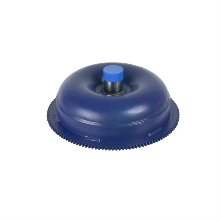

Your 318 will have a steel crank or internally balanced motor, the 74/75 transmission you just purchased the stock converter would be for a cast crank motor so you would need to follow this advice....
Elvad said:
Converter..
Cast crank motors need the weight on the converter. Steel crank motors do not use a weight on the converter. You can use a neutral balance converter (no weight) with a cast crank motor if you get the correct flexplate from B&M racing. A lot of converters now have no weight, Chrysler sells the weight and a template so you can weld it on yourself. (if you need one) I don't personally want to weld a weight on a converter. checkout www.bmracing.com for more info. If a converter with a weight is installed on a motor with a steel crank it will shake noticeably at idle and vibrate pretty good thru low RPM. I have seen this many times. At first you think you are chasing a skip.
